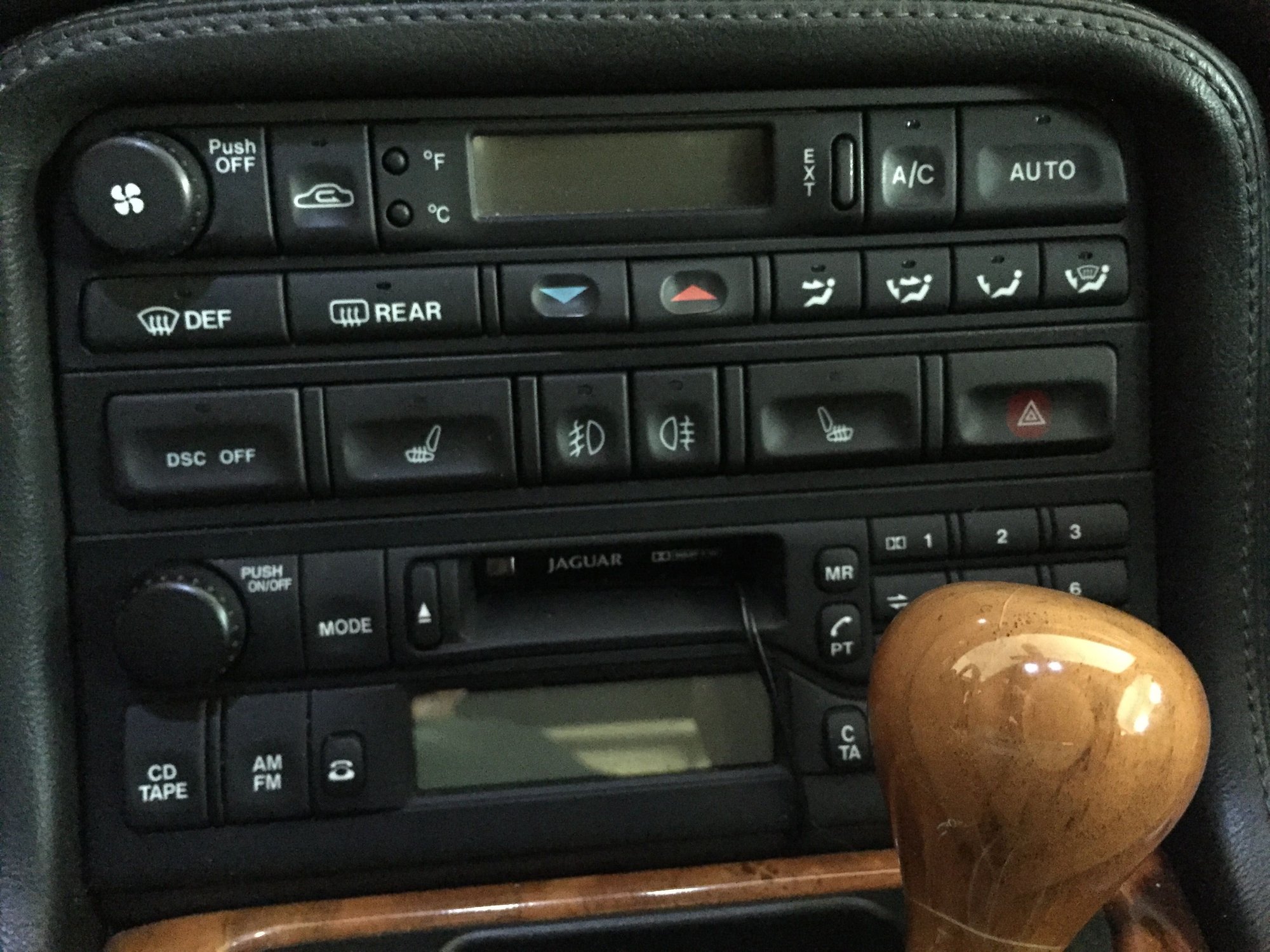

Over the '97 - '03 model years different centre console switch clusters were used. Besides the heated seat and non heated seat options buttons, the other outward differences were the left hand buttons. They were labeled either TRAC OFF, ASC OFF, or DSC OFF (see the accompanying photos). My '03 XK8 has a DSC OFF switch button. My hazard warning switch is sticking and I want to replace the switch cluster. Does anyone know if all these clusters are physically interchangeable and their internals are functionally the same? If so, all I may need to do is transfer my DSC OFF switch cover over to the earlier year replacement cluster.

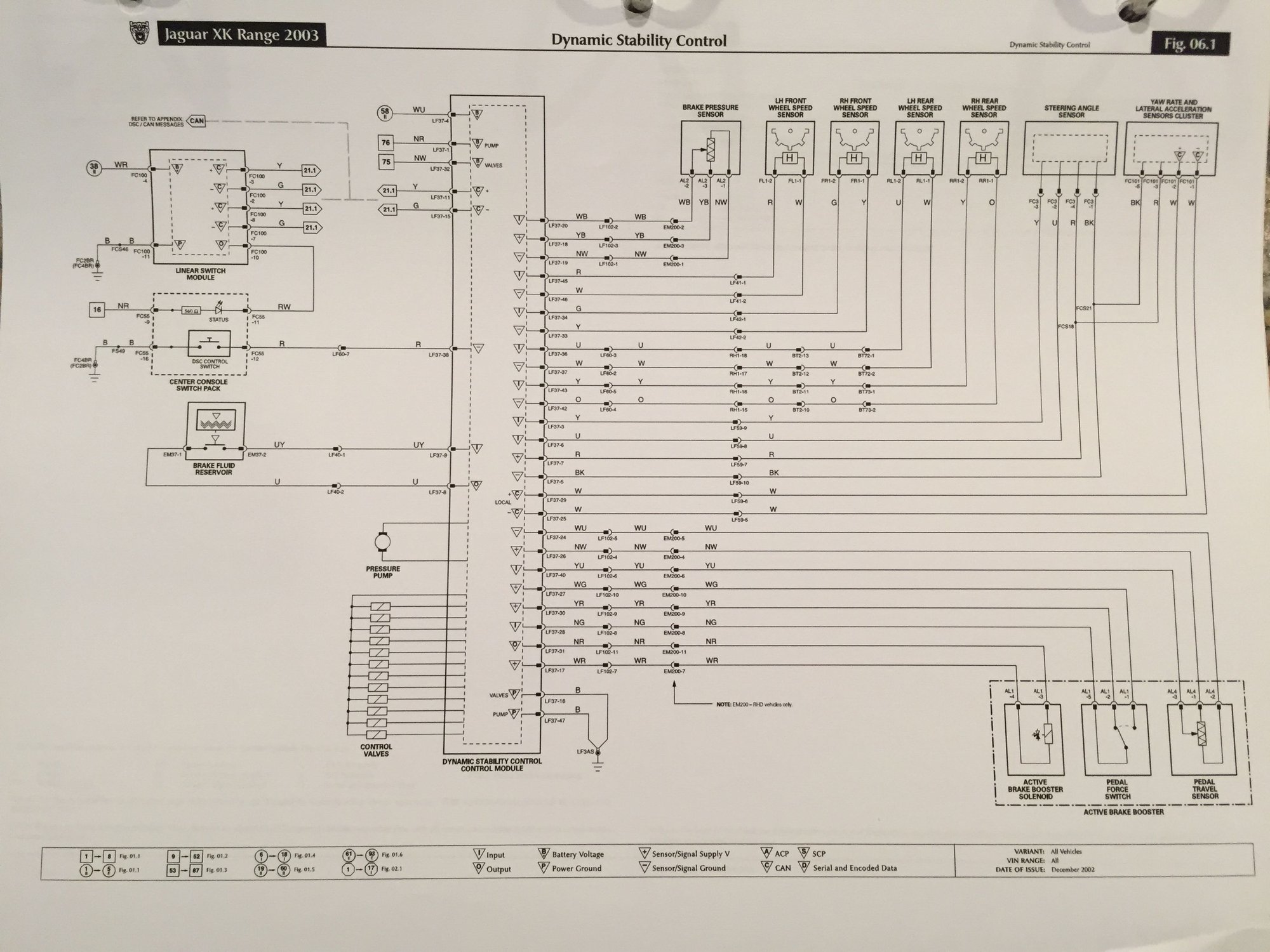

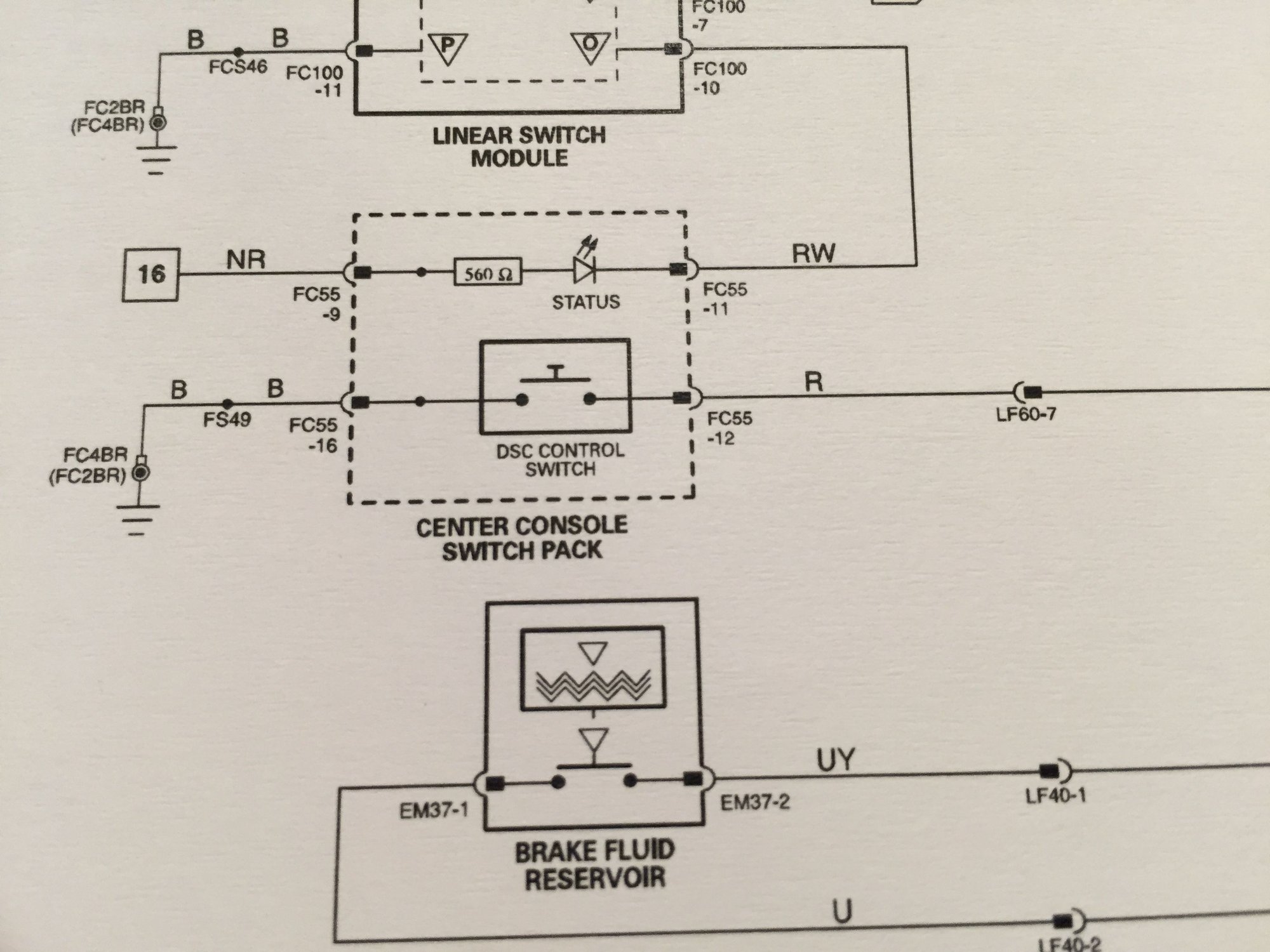

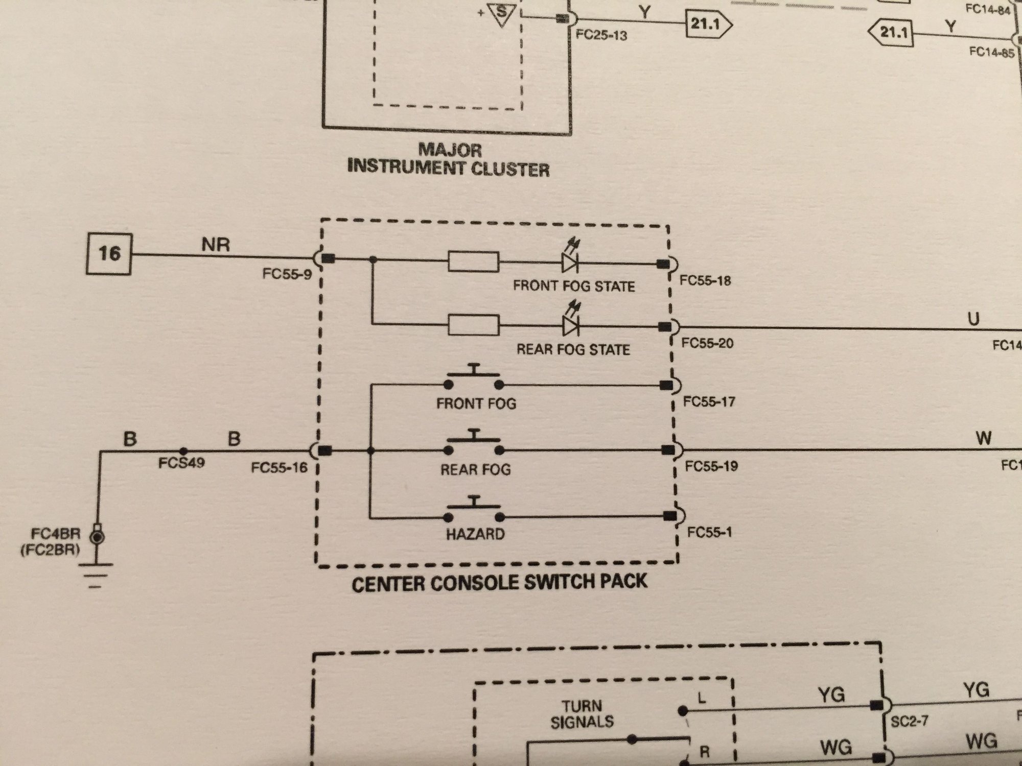

Bill I just looked at at the schematics. All of the buttons in the console switch pack you ask about energize by grounding.
I could find the DSC button in a schematic, but can't find Trac Off anywhere.
I can only assume the Trac Off will be transparent.
ASC? It involves an complicated array of adaptive speed control module, various inputs. I'd go for DSC before this one.

I looked in my 2003 XK8 workshop manual. It shows all the buttons in that centre cluster to be basically grounding switches. If the TRAC OFF and ASC OFF buttons in earlier year cars function the same way, as simple grounding switches, it makes me think all three clusters are functionally interchangeable. If so, I may be able to simply remove the button cover marked DSC OFF from my current switch cluster and install it onto the replacement cluster and everything should work. What do you think?

Bill I was in there today. Yes you can swap the button cover for DSC. Not so easy for either of the fog lights though.
You know thinking about it, looks like each of the buttons feeds a self contained switch pack, if there was ever a need you might be able to swap the hazzard pack into your current unit. Just an FYI,much easier to swap button cover as planned.

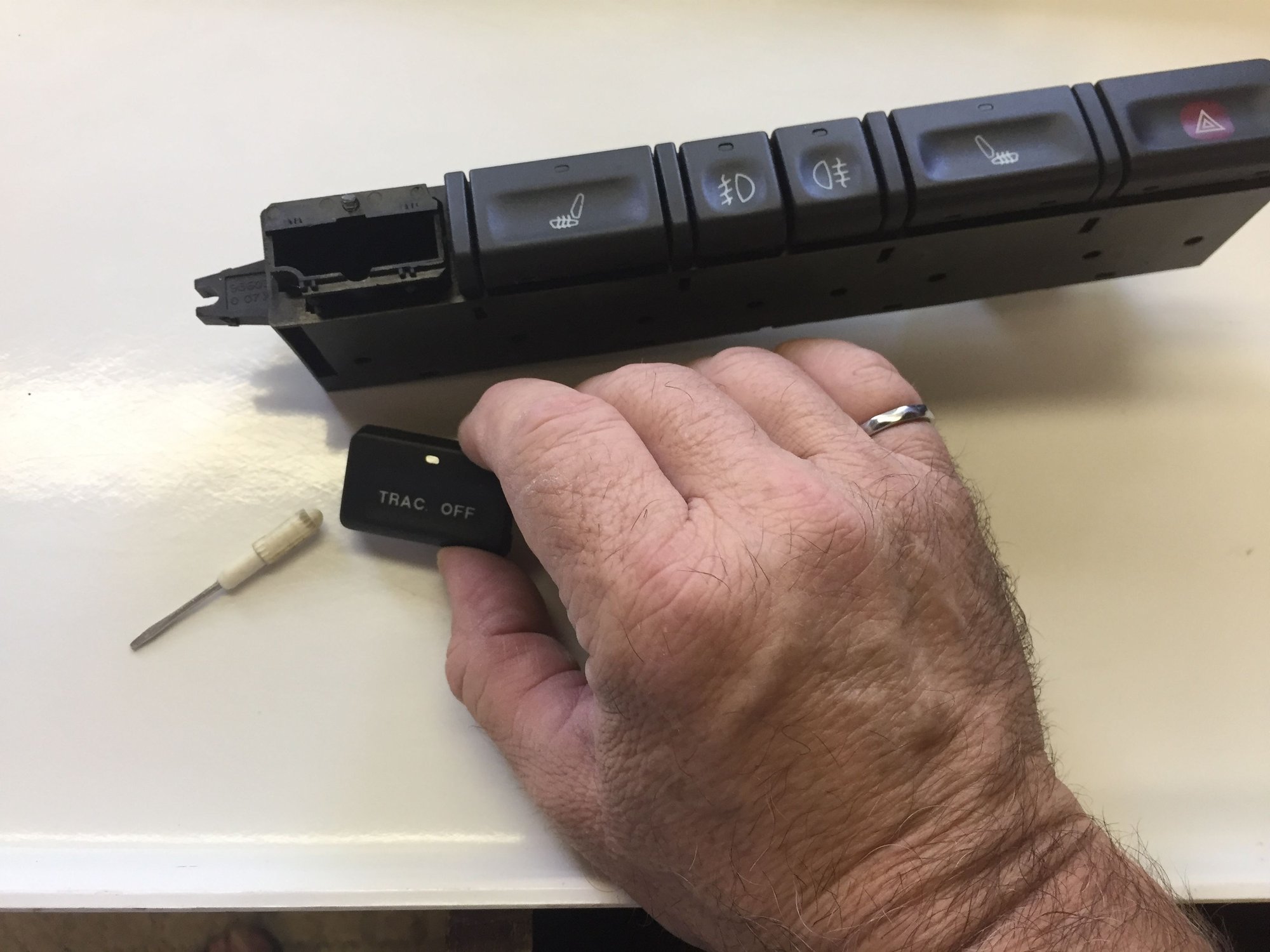

Old Aug 1, 2020 | 06:39 PM
Canuck pump engineer's Avatar
Posts: 3,864
Likes: 83
From: Hoschton Georgia and Canada
John
I obtained a switch cluster from a 1997 XK8. The TRAC OFF button cover popped off easily. So far, everything else looks the same as the cluster in my 2003. I think this will do the trick!
