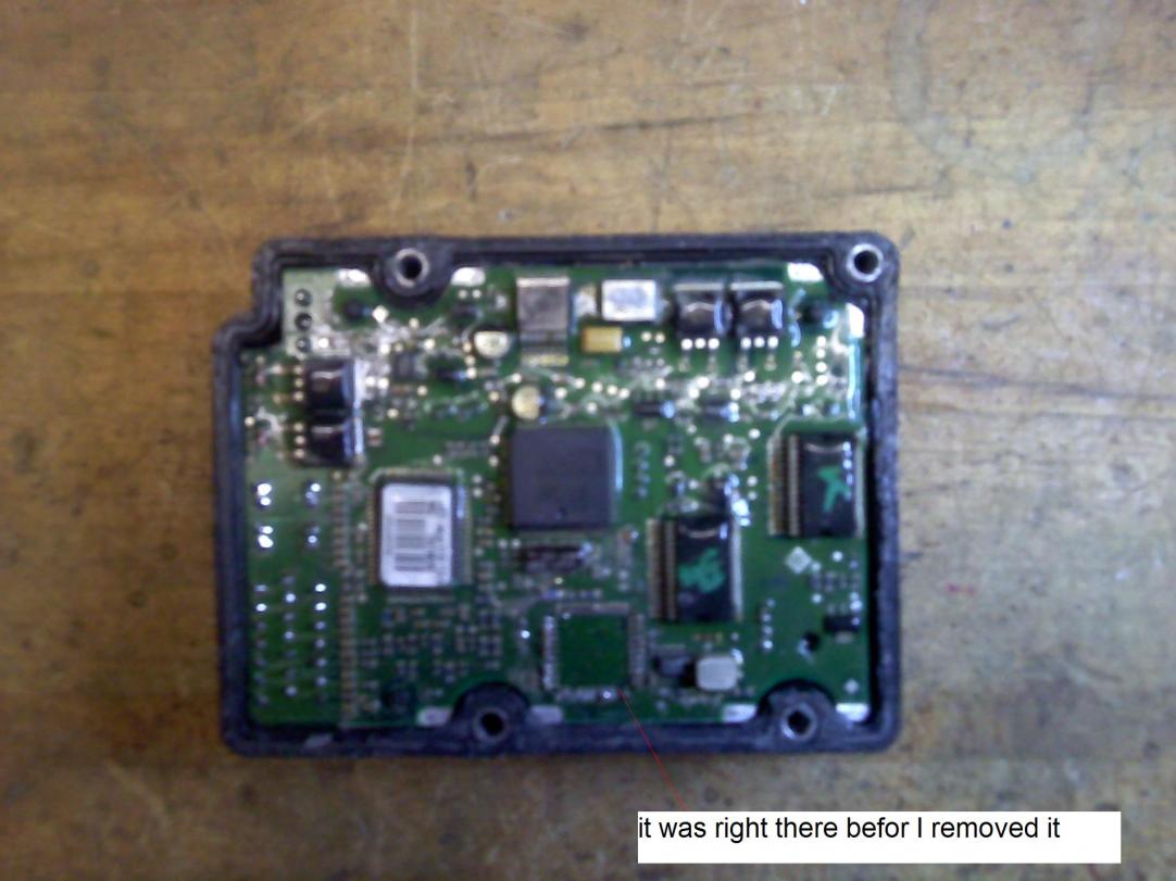

Hey guys wanted to give an update on my ABS module problem. Tried the do it yourself fix and ran into a problem.
Seperated the cover and found the bad solder joints. Fixed the solder joints, replaced the cover and put back it the car. Started it up and all of a sudden had a bunch more errors. Check engine, ABS, Brake, and display read INCCORECT PART FITTED. Also when I drove home found that I didn't have a speedometer.
While seperating the cover I inadvertently messed up the intel processor CAN chip (oops). Not all modules look the same as the ABS fix posted here. I was able to procure a Bosh replacement processor from Future Electronics for $5.50 part CC770. Intel stopped production of thier chip in 2007 and the Bosch is a suitable replacement. My problem was some of the paths on the board got damaged and it's a mutli-layer board which are pretty impossible to repair unless you have a schematic of the PC board.
Quick note: on the 97's the speedometer uses the wheel speed sensors for the speedometer. Also my unit has the CAN processor chip in the ABS unit which I didn't notice in the DIY fix it. I have attached a picture of my units internals.
Did a search for jaguar junkyards online and posted a request for the module. Started to get phone calls right away and a guy named Kevin from Used Part Nation was able to help. Had a unit in FL and charged me $365.00 delivered. Only thing was I had to get the whole assembly for that price, pump and control. That's only $5,150.00 if I bought them new.
Told me the unit tested good and gave me a 6mo. warranty. He said he gets them every few months and if he couldn't replace it he would return my money. Got the unit Wednesday and put it in. Inluded in the packaging was also the VIN of the car that donated it, thought that was a nice touch. Started the car and all the errors were gone except for the original trac/stab fault, also got my speedometer back, yes! (see quick note above)

Great info!
Can you say how the processor got messed up so I don't do the same thing?
Cut too deep?
Dog ate it?
Spilled beer on it?
Thanks,
Dan
Old Aug 5, 2010 | 11:10 PM
DpezXK8's Avatar
Posts: 441
Likes: 113
From: St Charles, IL
Yep, cut to deep.
If you look at the pick you'll see the chip in in between the two posts. Well I couldn't seperate the cover without cutting the posts and in the DIY it looked like he had cut his. But in his picture there wasn't anything around the posts. So suprise and major woops, wiped out the legs on that side of the chip. Looking back on it I'm not sure you have to cut the posts but I wasn't paying that much attention, just following directions. There are retaing clips on the top of the cover so if you remove those you can probably just lift/pry the cover off. Hate to admit it but stupidity and impatience got the better of me.
