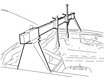

With the engine supported from above, the transmission can be unbolted and lowered from the car:
The SNG deal sounds as if they are supplying rebuilt unit when they want yours back. That's going to be as costly as getting the replacement out there in the first place.
