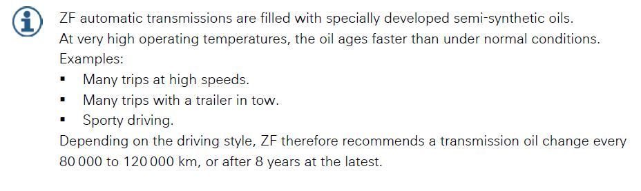

ZF originally claimed its 6HP transmissions were "Sealed for Life," but subsequently the company revised its recommended fluid change interval as follows:
It's fair to assume that a high percentage of Jaguars experience trips at high speeds and/or sporty driving, so this revised interval probably applies to most of us. This equates to a fluid change every 50,000 to 62,000 miles or no later than every 8 years.
I am attaching the ZF document that presents this revised service interval. I'm also attaching a document from a ZF parts dealer that gives important information on the valve body seals that should be replaced when the 6HP is serviced, as well as ZF instructions for replacing the electrical connector sleeve that often develops leaks and should also be replaced when the transmission is serviced, since the sleeve lock can only be unlatched with the pan removed. On the Mercedes-Benz 722.6 / W5A580 transmissions the connector sleeve has a small captive hex-head screw in the center that must be loosened to remove the sleeve.

The date on the ZF document I posted is 12/2012, so presumably its 8-year specification supersedes the 1998 10-year specification.
Reply 4
Feb 12, 2024 | 09:58 AM
  #30
^^ It indeed does. I spoke with ZF Tech Support in Chicago about a month ago. 8 years is correct....
