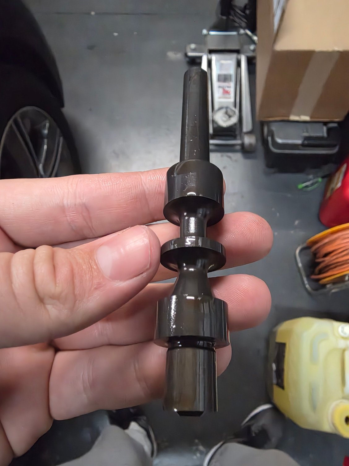

Originally Posted by michaelh
Was there any sign of metal particles in the transmission pan?
Was there any sign of wear on the old valve?
edit: My understanding of shifting slowly through the gears is to ensure that the various fluid galleries are all filled as part of the process. You would likely be a little low on fluid level if you missed out this step.
Also, if the fluid temp exceeds 50 degrees, then the fill will be below minimum. Shame there's no dipstick...
Nope zero metal particles, and the old valve looks good, thats why im annoyed i've messed up a healthy transmission, heres a picture.
Alrighty then, ill go for attempt number 3. Sorry for all the rookie errors im 19 and this is my first Jag. Got it for 1500$ as a project with only 76k on it. Absolutely fell in love with it and the brand. its great to see the support these cars have from such nice people. Im super thankful for all the help. I'll update if third time was the charm.
