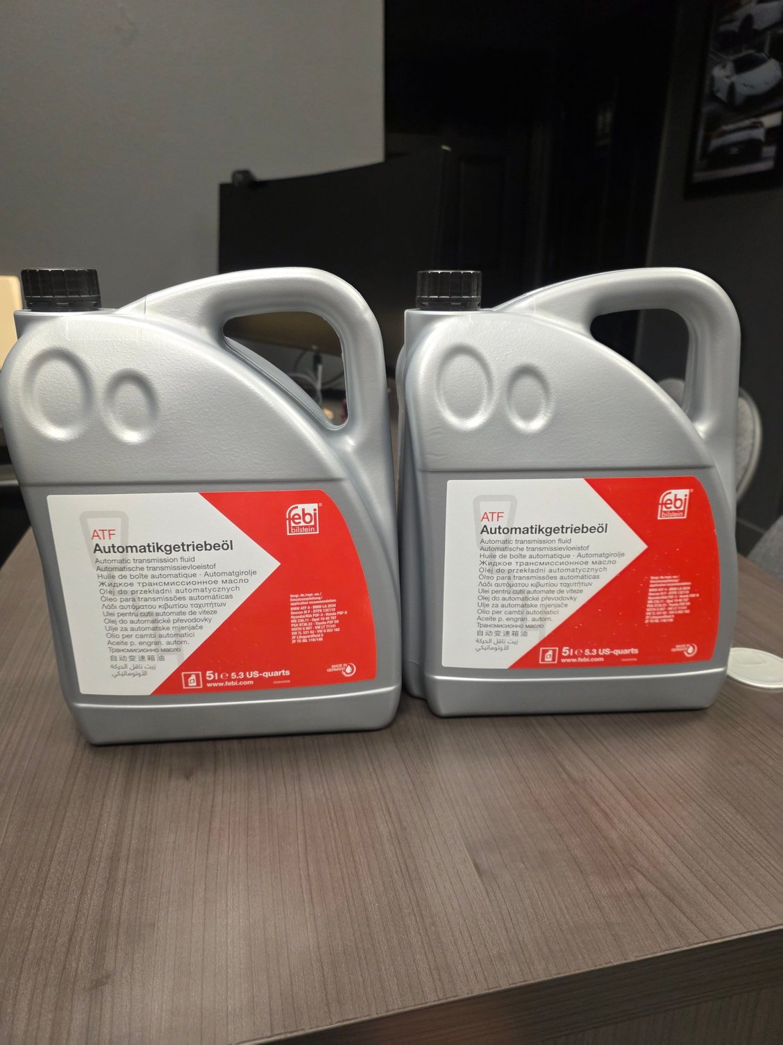

second, after researching the topic quite thoroughly I opted for the original speced fluid )febi atf) expensive, yes. Hard to get in USA, not really.
third, follow the crazy oem process of replacing fluid as best as you can. I jacked up front of car and put the rear on jackstands keeping level front to back. I removed fill plug and pumped in fluid with a ten dollar hand pump till spilling out fill hole. I then started car, and had my neighbor cycle through gears while i continued pumping in fluids, once it came out fill hole I plugged with bolt and let cool. I didn’t have proper scan tool for temp readings or even infrared gun. I waited a few hours to cool. Then I did whole thing again. Afterwards, went for a few short drives and could tell something was off/wrong. I ordered more
fluid and did it all again still with no temp readings, and managed to get about a quart and a half more in. Next test ride, I could feel and hear the difference. Did about 200 miles and drained fluid out again(not dropping pan this time) and refilled twice more….holy **** what a difference!
go to Amazon and search for the proper fluid. It’s worth it. And read up on proper procedures and do the best you can, you’ll see the difference.
If the trans was fine before, and you researched enough to get the trans go kit, you obviously dropped the pan and valve body to do it. Hopefully you changed the trans filter while in there, and sealed up the pan with new gasket. Why you opted for an “equivalent” cheaper fluid is beyond me, but in my research I found so much confusion and conflicting info I just went for the original speced fluid, and yeah it’s a little more expensive than “equivalent” fluids, but it’s cheaper than replacing or rebuilding a trans in these cars

Just to be clear, the original specification fluid was ESSO LT 71141, which has been re-named Mobil LT 71141. Febi Bilstein Automatikgetriebeöl (ATF) nr. 29738 is an aftermarket fluid but we have proven it to be equivalent to ESSO LT 71141. For other known-correct fluids, see Post #11.

Good news!!! Turns out following instructions works! I got the correct fluid thanks to you guys, filled, went through the gears, topped up, the fluid out of the fill hole was at about 38c , flowing out as borderline single drops, still a very very thin stream. Now there is not grinding! There are clicks that sound like the same clicks cars make when they are cooling down but even when idling or driving sometimes, not sure if the fluid still needs to settle in or something but overall besides those clicks that hopefully go away it feels great!!
