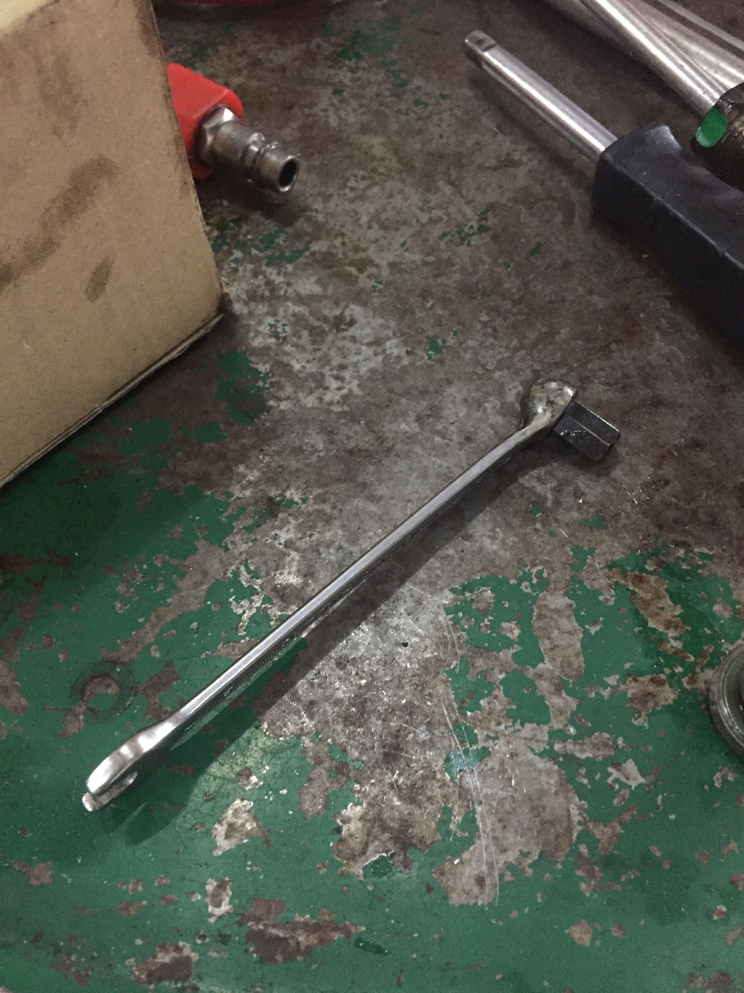

1. Corroded T27 pan bolts are a real pain to remove on the ZF5HP24. Impact wrench is a must. Make sure you have a spare tool bit as it's easy to strip one. Have spare bolts to hand too (or in my case I just replaced the entire lot)

7. I used a lift at my local mechanic's shop, when he had a slow day at the garage. He had one of these tools made up for this job, for easier access to the filler bolt. Access is a bugger especially between the hot exhaust pipe and the side of the pan. A lot of forum members had burnt skin from this location.
