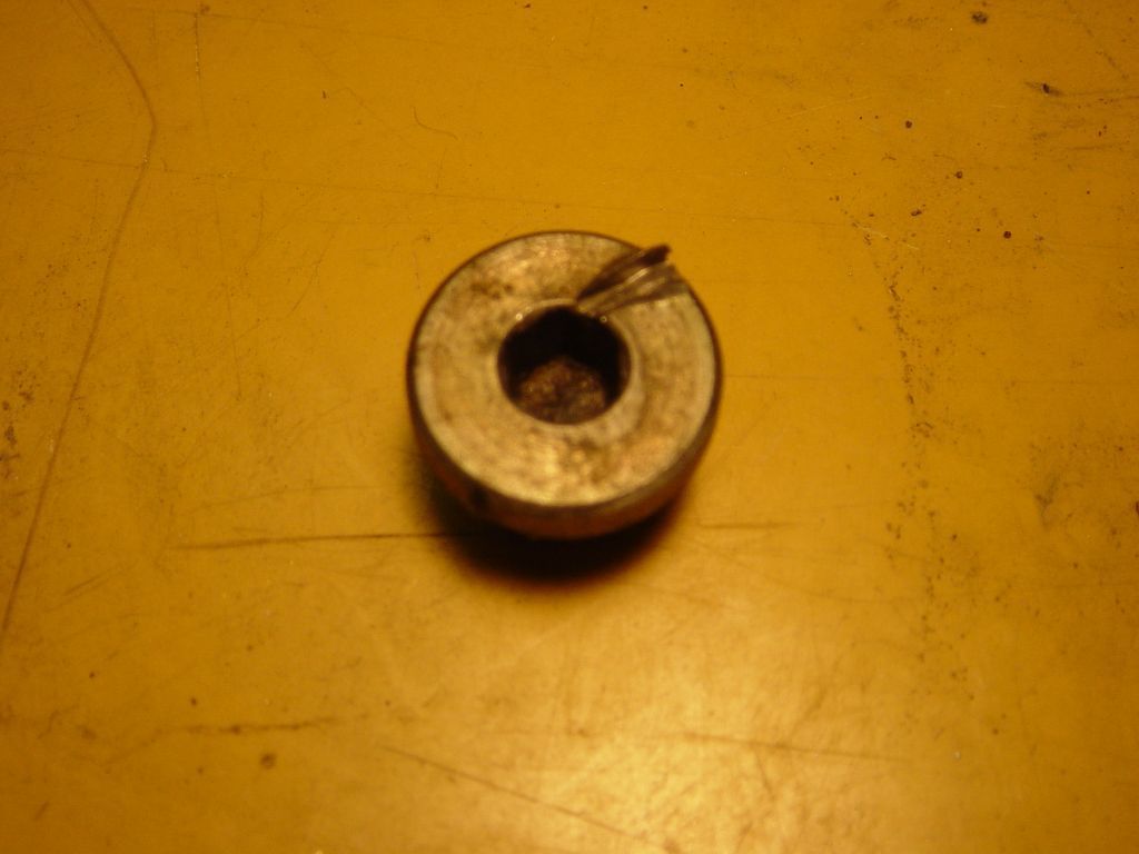

Mine has the sqwark and everything i have read or heard suggests a filter change is the best solution, obviously this requires a fluid change too but i have been trying and failing to change it for a while. first attempt i realised i had the wrong fluid (i got mannol atf ag52 which is suitable for 5 speed zf). I now have some mannol atf ag55 but rounded off the fill plug so waitong for a extractor bit to get it out.

A cold chisel can be manipulated to free the filler plug. You might drop the rear end of the gearbox for more access.
I saw this exact pic in another thread and tried it but as i am working on axle stands i didn't have much room to swing the hammer and couldn't get it to move at all. Saw a solution using a stubby hex head extractor so ordered a set yesterday.

I use a pneumatic air hammer with a very controllable trigger.
A long shank chisel will reach into the area between the exhaust and the case.

I can get the chisel into the gap fine once the heatshield is off. I even managed to cut a slot into the plug, just couldn't get enough swing on the hammer while laying on my back to turn the plug.
am pretty sure i can get it out with an snapped bolt extractor it was just sod's law the one i had was about 1mm too small to bite into the plug.
I did a fluid change on the ZFHP5 tranny in my old VanDen Plas, but, am I seeing that this fill plug can't be extracted with a hex bit, or conventional tool, even under ideal conditions ? I mean was it made so that it can never be removed without resorting to Brutal measures ? (pardon the pun)
Theoretically it can be removed with an 8mm hex bit but on my 17 year old car which has probably never been filled it rounded as soon as i applied modest pressure.

I finally got the fill plug out after using a hex head extractor with a 13mm box spanner attached and eventually beating the spanner with a hammer. Once it opened it unscrewed by hand.
Something VERY unexpected happened next... once the plug can out fluid started pouring out of the fill hole. And i mean pouring, like i was draining engine oil. Thankfully i wasn't looking directly at it as it came out, i also hadn't driven the car otherwise i would have been severely burnt.
Seems it must have been massively overfilled at some point, which may have explained the noises coming out of it.
in fact it looks like more came out of the fill hole than did from the drain hole
