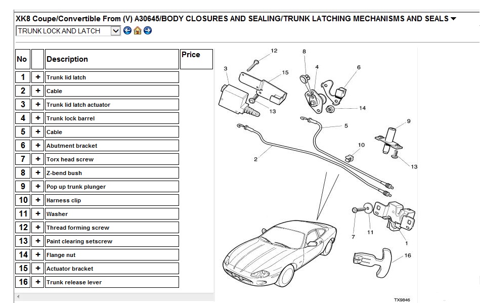

I'll say 'NO' because the Actuator (item 3) is electric but you should be able to open it with the key because the barrel (item 4) has a mechanical link (item 5) to the Latch (item1).
