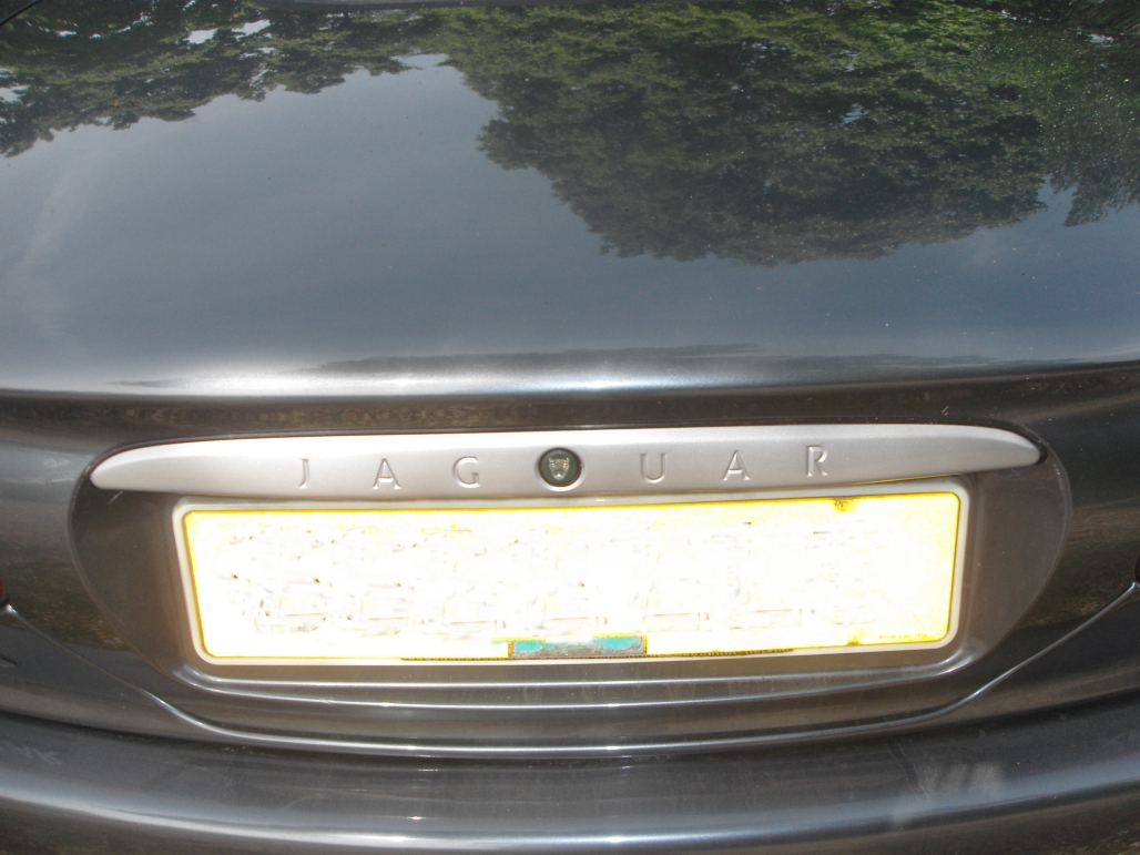

I have a boot release button, which I don't think was standard on the 2007 model, and it doesn't work. I'm not particularly bothered - the internal button and the key-hole are both OK, but it would be nice to know whether it was part of the original car, or put on by a later owner.

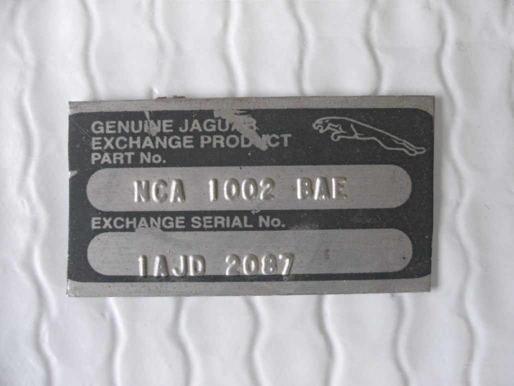

I have also found a note in the service book to the effect that a new engine was fitted at 64k miles in 2001. I assume that was because of Nikasil issues, and for me, that's very good news. I have also found, in a separate envelope, what I think is probably the engine tag from the replacement engine. Do the numbers on it mean anything to anyone ? I would guess that it has "second generation" tensioners so will need some attention at some point, but is there any way of knowing that from the letters and numbers on the tag.

I do not believe that the replacement engine serial number has been demonstrated to report any information. Making the assumption that the replacement engine had the upgraded tensioners is not a valid one. You should verify by removing a valve cover.
Trunk (boot) deck wiring has a common fail point at the right hinge where it is constantly flexed by use.

I'd investigate and fix any malfunction of the boot locking system. better to check when you can open the boot rather than on the day you're locked out.
Like test point, I haven't found any information on replacement engine serial numbers. However, a number of sources report the rebuilds were not done by Jaguar at the Bridgend engine factory but were sub contracted.

And if it's a 2001 engine, you will definitely want to check to see if the tensioners have been replaced.

The JEPC lists NCA 1002 BAE as a "stripped engine" - so I think it unlikely that metal tensioners were fitted in 2001. I suppose that if it were a Nikasil issue, then the original tensioners might still be on the original heads.
