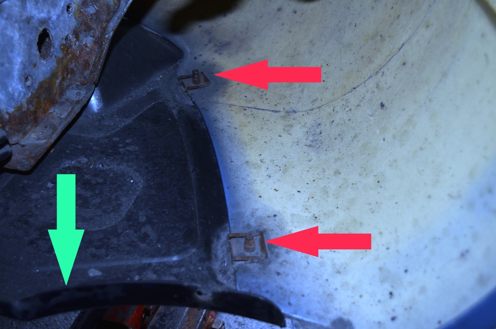

I've gone through photos of my 2005 XK8 and there was no deflector fitted. This is the LH wheelarch.
This photo is looking forwards in the RH wheelarch with the liner removed.
Green arrow is the lip at the back of the undertray. Red arrows are two of the undertray fixings. No wind deflector or even provision to fit one.
Jaguar reintroduced wind deflctors on the later XK
