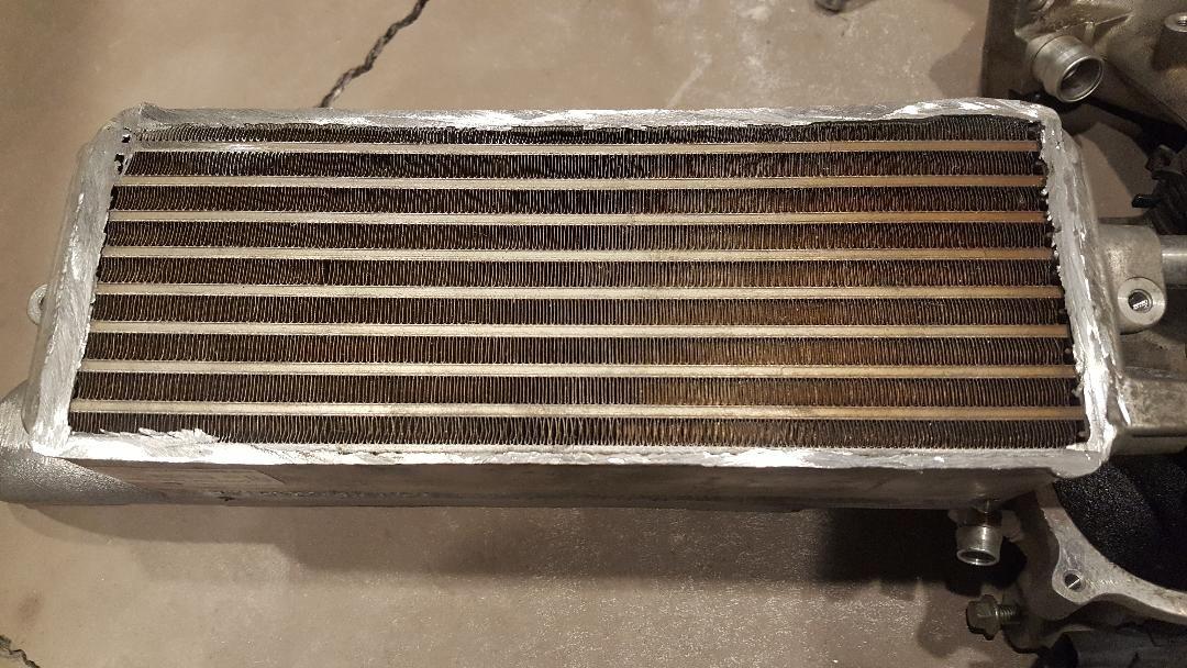

Not sure if an image of the Jag 4.2L SC Intercooler has been posted with the top cut off.
Here one is. I am wondering how they cool effectively with inlet and outlet on the same end. A partition between the inlet/outlet?
As one can see, the intercooler manifold is fabricated by welding the bottom manifold and top inlet plate to the radiator module.
Anyone cut off the inlet plate?

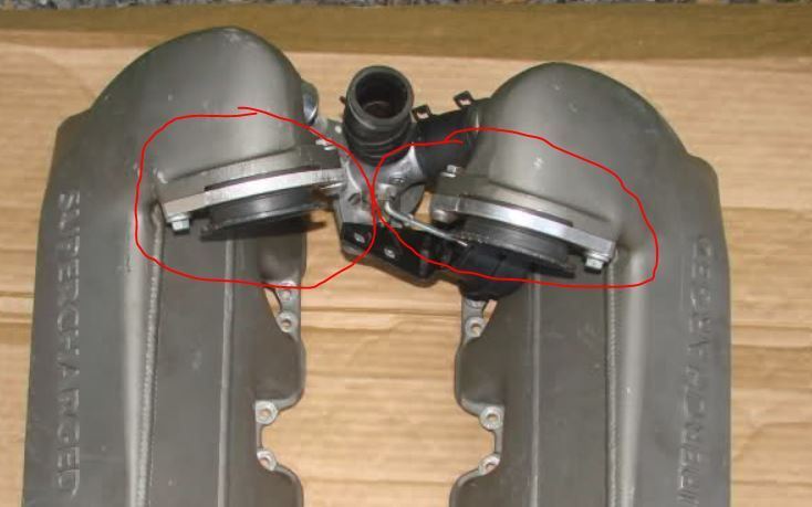

I have a question. Can someone post the inlet diameter of the Intercoolers on X100s? (See image below.) Thanks.

Tijoe, This is the choke point of the system....You can't Port the Rubber Seals, therefore whatever they will allow is the most you will get.....Sorry, I don't have a set of Seals to measure.....I don't know of anyone making over-sized Seals!

[Tijoe, This is the choke point of the system....You can't Port the Rubber Seals, therefore whatever they will allow is the most you will get.....Sorry, I don't have a set of Seals to measure.....I don't know of anyone making over-sized Seals!
Is the Lake frozen over yet?
Billy Clyde in Houston]
I am looking for the diameter of the openings in order to calculate the inlet area then compare this area to the inlet area of the Newer intercoolers (S-type R and others.). Then run some velocity calculations versus flow volumes.
