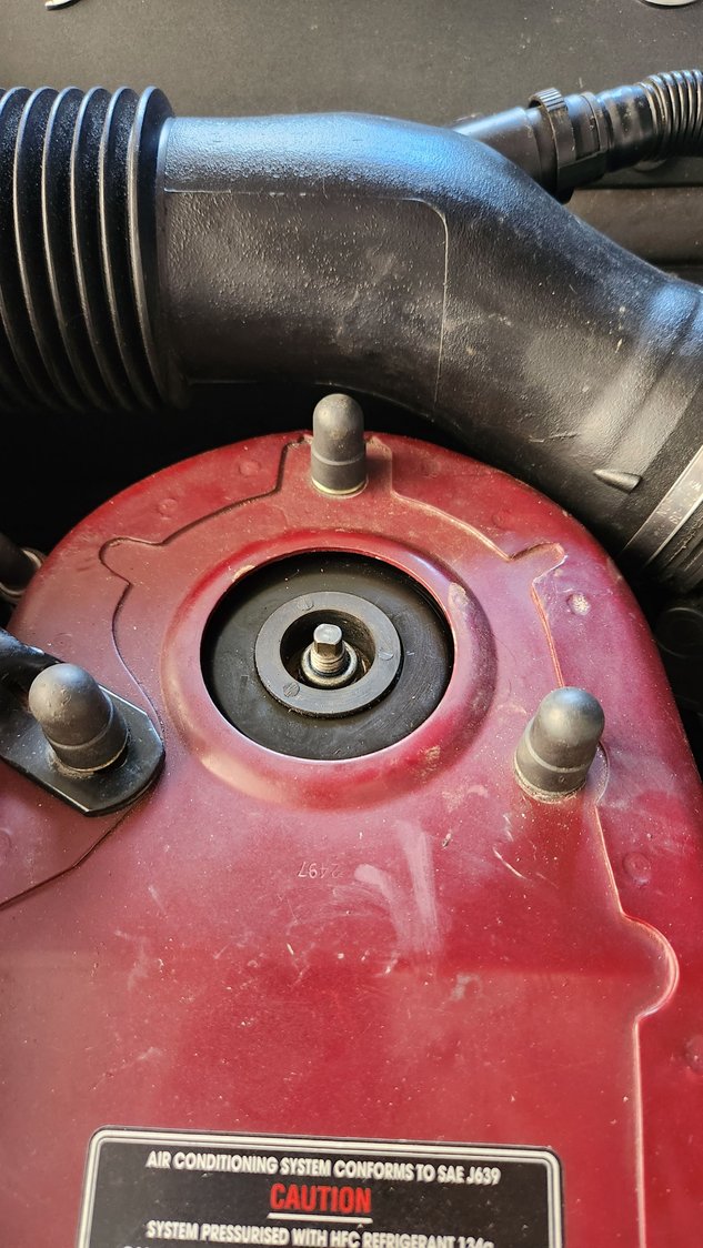

Hi all,
I had my upper shock mounts replaced on my old XK8, along with all shocks and springs and various accompanying parts (standard suspension). However the shock mounts don't appear to have been fitted very well/centred, especially when compared with photos of other cars. Within a week the top of the driver's side shock/strut has moved about a centimetre further off centre.
I presume this is shoddy work and will need to be refitted? The mechanic who performed the work messed me around for weeks then appeared to rush the job and I'm concerned it was not done properly. Would like to know what you all think. I do have steering wheel wobble and vibration but this was an issue prior to replacement, however it does feel slightly worse now after the suspension was replaced.
Driver's side
Passenger Side

The mounts do wear do over time but those mounts have not been fitted correctly as there is no way that they can wear within a week and even when they do wear I have not seen them that far off centre. The top mounts have either been fitted incorrectly or an incorrect part used.

Might be as simple as the garage was tightening up things as they went along.
This particular area needs to be in a neutral position (car on the ground and rolled around a bit) before torque is applied to the upper three studs and the bottom bolt and for sure the rest of the front suspension (if replaced) has got to be done in this way. If not a twist can be in the system and with the weight of the car on every up and down, these twist on all of the new bushings (as the owner of this thread has done), then a lot of things are having resistance in any direction. .
Just a observation and correction could put you back to center. Not going to fix the mount issue through.

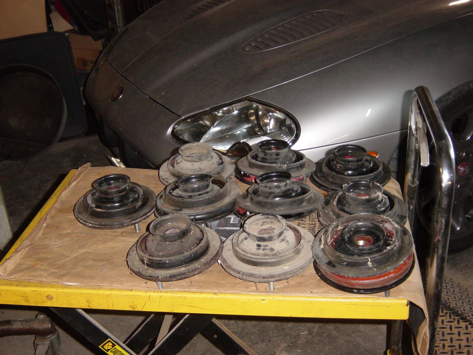

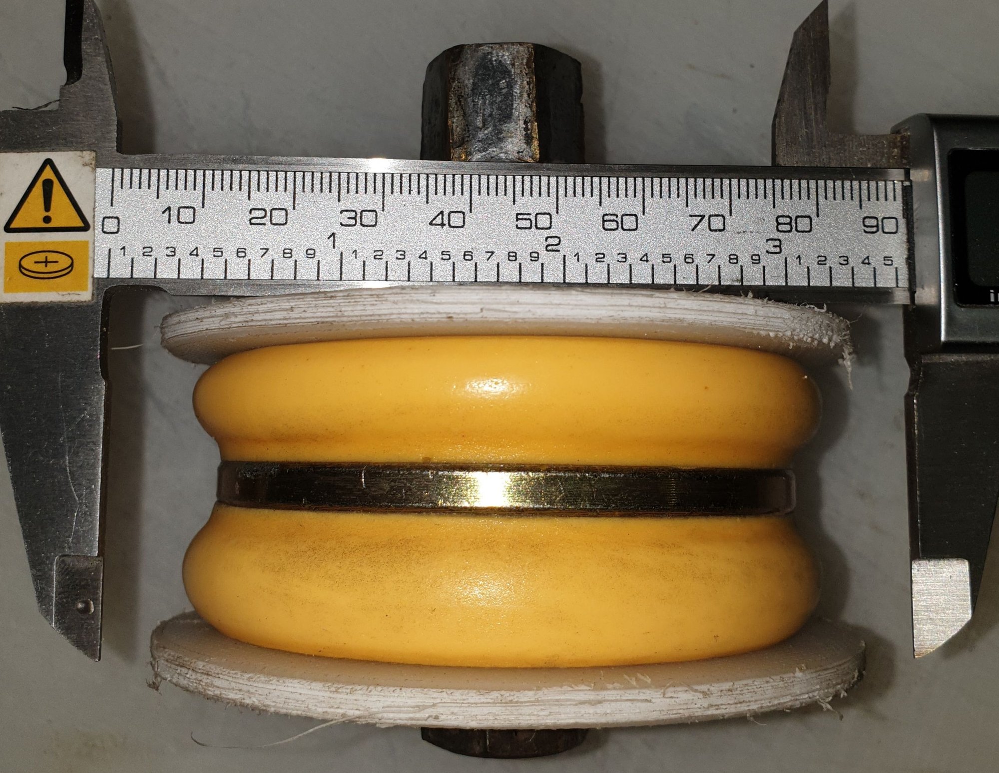

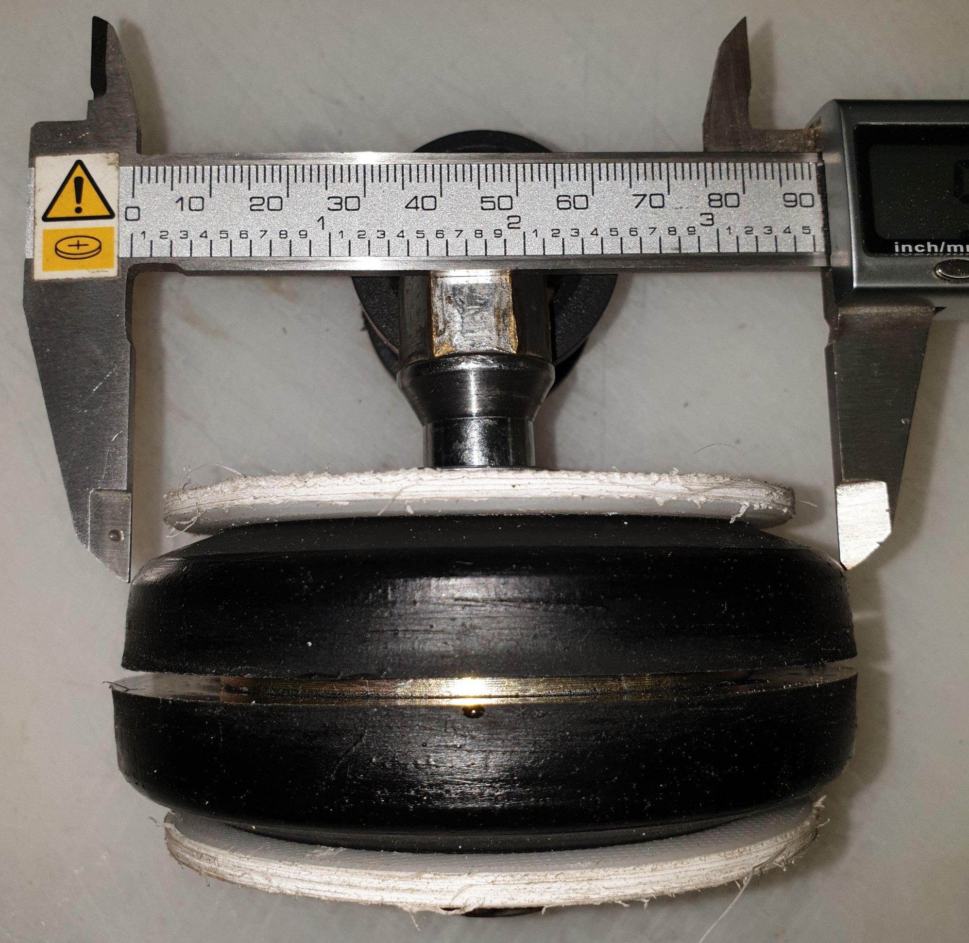

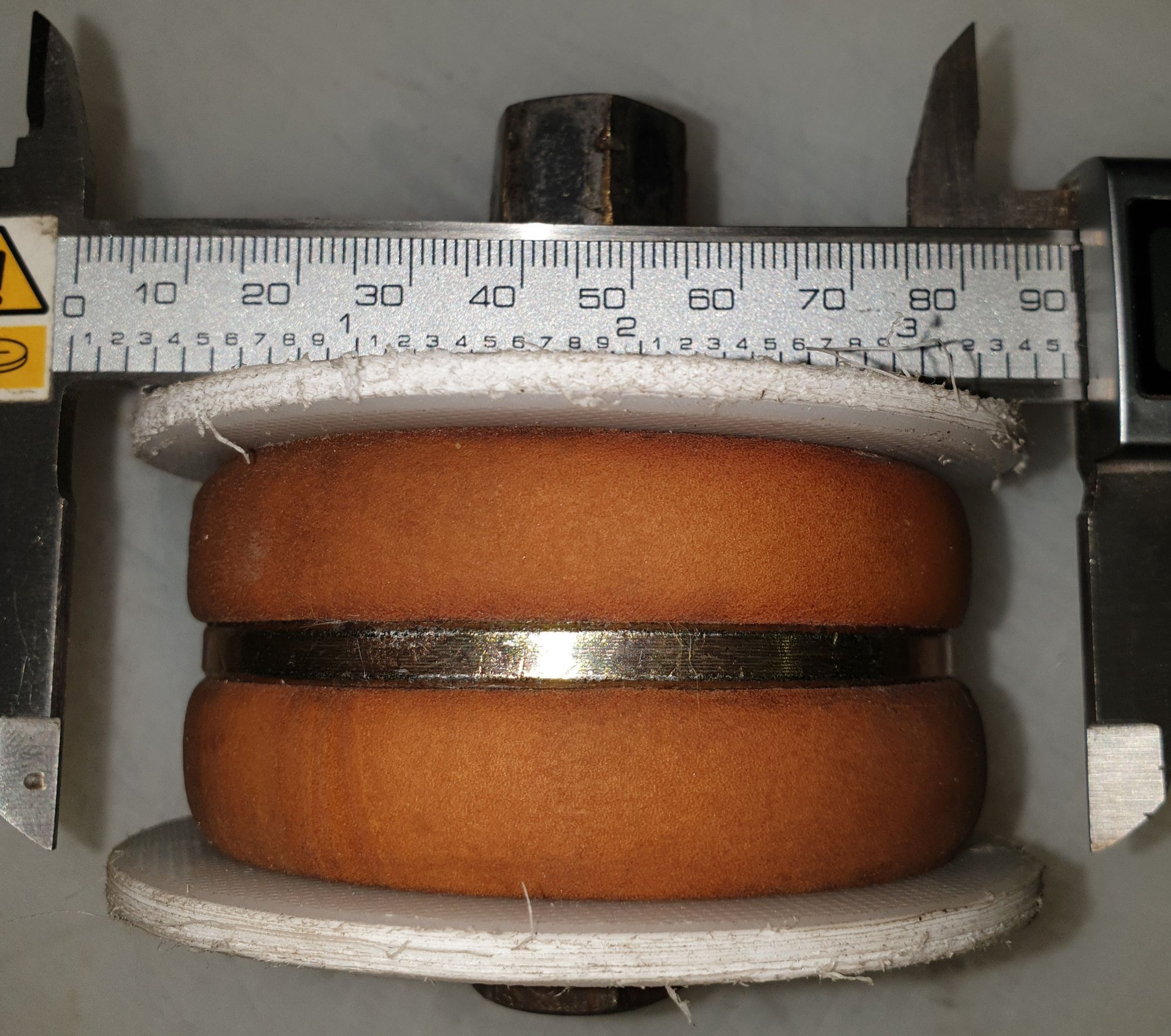

Envious of Wayne regarding the mounts but might take this opportunity to post some pics to illustrate why l went the direction l did on poly top mount components. Calipers in pics are set to internal diameter of mount bell and bush stacks are compressed to assembled stack height. Easy to see where our lateral movement originates and why the poly fixes it.
keep in mind also, the bottom mount hole in URO mounts is 25mm while the damper rod is 15mm so metal to metal is not too far away.
Custom polyurethane bushes.
Original Jaguar bushes
URO bushes
Welsh bushes

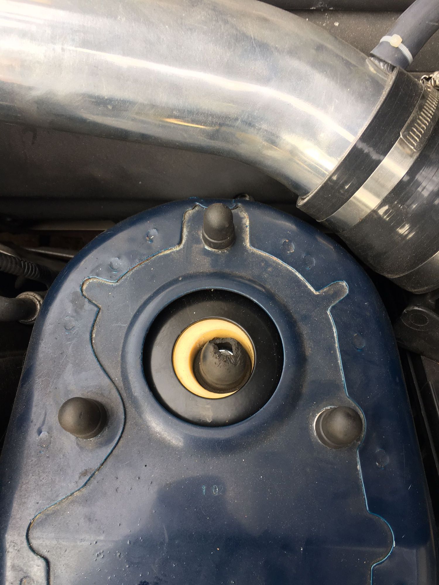

Hi All,
Just a wee update after changing out the shock mounts for poly units that I got from baxtor. Huge improvement. Road surface/vibration massively reduced. Cannot fault them and I'd expect that these will last me many years. Wish I had known better before I got the aftermarket ones but to be clear, almost every single supplier in the UK is offering aftermarket mounts alongside the Jaguar ones. And every single one of them is selling the same URO garbage and not listing it, except as 'OEM quality' or some other vague statement. I bought my mounts from SNG Barrett and Berkshire Jaguar respectively and it was the same product from both.
