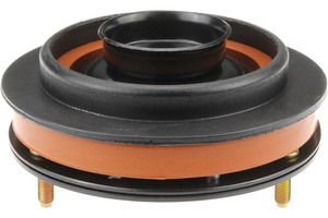

Exactly one month ago & 811 miles I replaced the front strut bushings with the URO newer style parts I got with the car when I bought it. Simple thing, yeah right...
Lucky me found out about the best replacements in market just days after I had already installed this URO garbage. Yes garbage that started falling apart in days and now are making noises. Lucky I do my own labor or I would go broke with this car.
Those replacements are hand made by Wayne right here in NC. Got a hold of Wayne thru a message right here on the forums and visited personally face to face. What a great guy. Today I picked up my replacements and will be installing them this coming week.

Hi 2003RagJag, that pair of yellow Strut Mount MJA2170BD that came with your car are the old design, which were updated in 2024 to orange PU material that's 42% more firm for better longevity, see https://www.jaguarforums.com/forum/x...-232078/page4/ for a detailed discussion.
Sorry URO support but mines were August 2024 Orange 🍊 and didn't last a month and they were off centered and had to buy Wayne replacements.
Mine were not the yellow ones.

Originally Posted by 2003RagJag
Thanks for the additional info! The mount in your photo is actually burnt orange, and not old yellow stock that was still on a retailer shelf in 2024? The new version is a shade of pumpkin color.
Money in the trash, had to buy Wayne replacements in just a month.
Photo of the day I installed them. Yes, the new style. 2024 the crushed pumpkin color

Got it, thanks! We'll have engineering evaluate another durometer increase. We did consult with Wayne in June of 2024, who recommended bumping up to 70A. The new orange bushings are halfway between the yellow OE durometer and Wayne's suggestion, since engineering was hesitant to deviate so far from OE. But in light of 2003RagJag's feedback, we'll definitely look at stepping up the durometer again for the next production run in a few months.

I think I speak for all of us when I say that we would all much rather sacrifice NVH if it means we can avoid replacing these shock mounts on a yearly basis. The functional lifespan on this part should be 10 years at a minimum.

Gian, thank you for your confidence in my efforts. Hope to be around to see one last that long. LOL
Not so sure the combination of parts involved in that suspension area being worn is not a big factor in the mounts having some of the issues.
One of the major problems was the washer that goes down to the shelf at the top of the shock stud was too small, took a while to wind that one. Remember how difficult it was to get your mount off, that was the problem, it had been hammered down the shaft. About every third one that comes to me needs to be reamed.
That's enough, sounds like they are on the way to having a good product. Here's hoping.

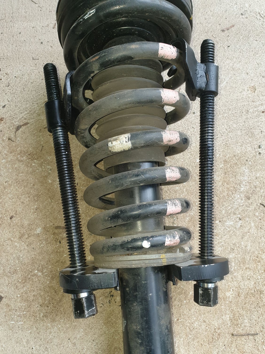

I have found a good bit of the time spent on our front ends is tied up in removing the springs themselves.
l modified a spring compressor to jag specific specs which drastically reduces time taken and fear felt on that task.
simply locks into lower spring seat.

baxtor, I really like your compressor. It looks to me like you could change out tops with it still in the car. Use a sideways air rachet and drop it down after compressing the spring.
Clever indeed.
