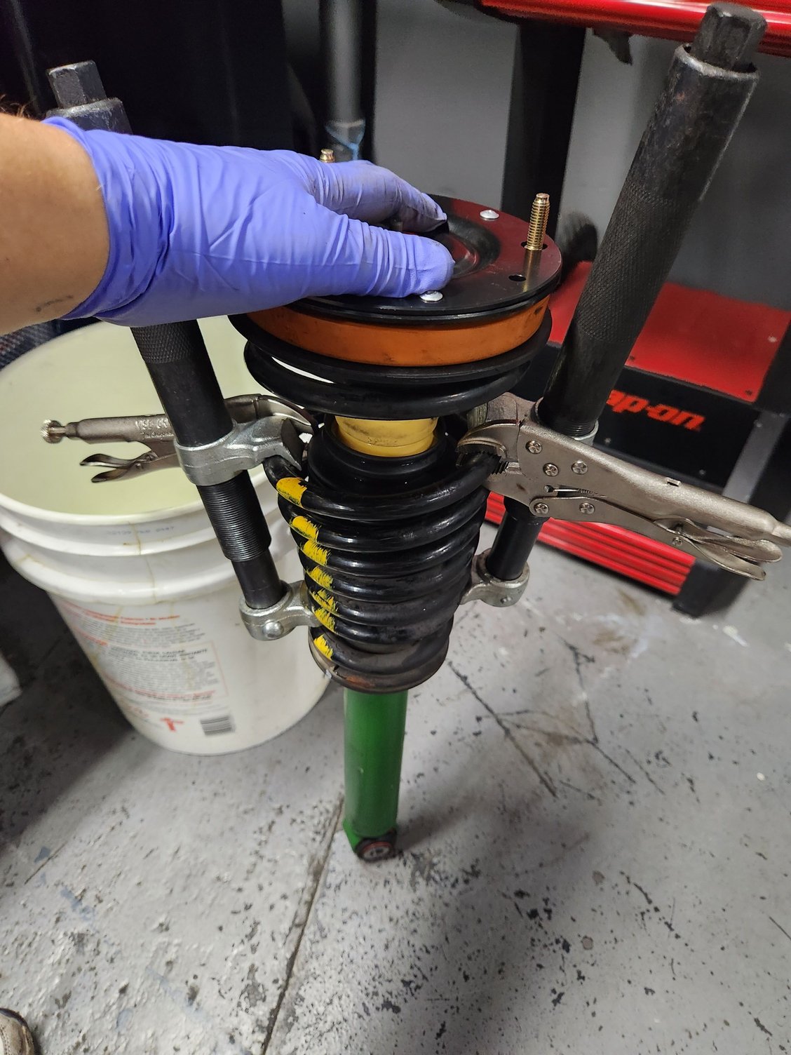

One of these would help, a little stuffing around to build but really simplifies the jag front spring removal.

The manual suggested one like I have. I think @baxtor has a cooler one!!

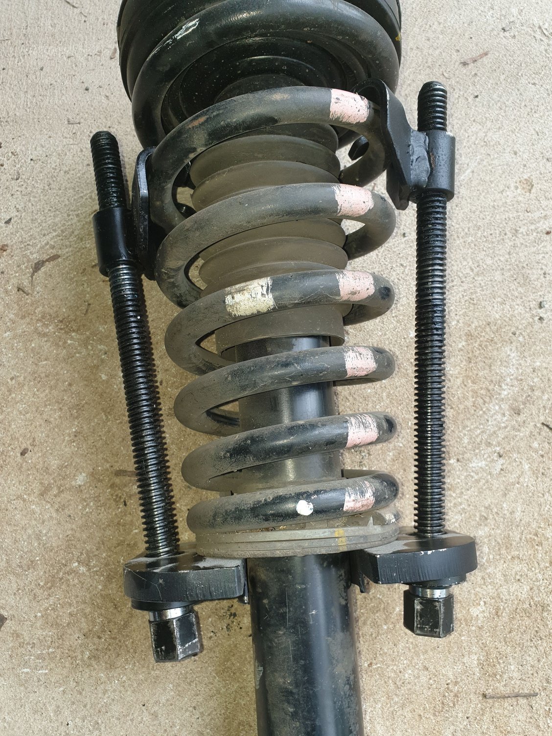

Default Tools
The first time I changed the top mounts I used this rented tool from Advance Auto, please stay away from this tool, lucky I still have my fingers.
The second time, yes the second and only one month later. This time using Wayne's parts. I removed both struts and took them to work. In less than 5 minutes I replaced both.
