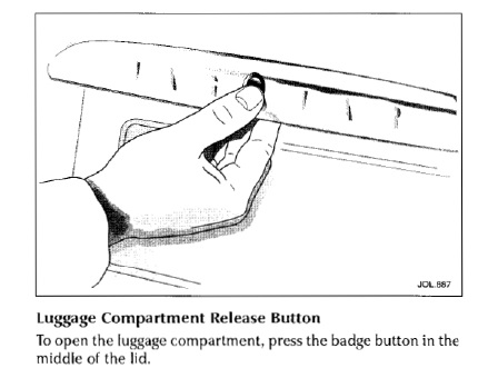

Hi all my boot won't open with button ok with key, fob, button in car, any ideas thanks
A perfect example of why we ask members to add vehicle details to their Signature.
The early XK8's didn't have a release button in the centre of the lid trim although several owners have retrofitted one.
You should add whether you have an OE fitted release button and also if it has ever worked since you purchased the vehicle.
