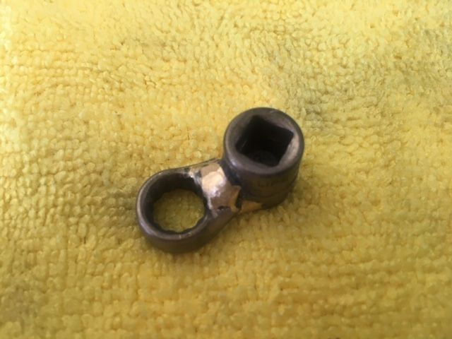

Default Necessity is the mother of invention
Could not find an 8mm crow foot for a 1/4"drive. Strong enough for these low torques. Only added about 3/4" to the length of the arm, so I went a bit lighter on the torque.
