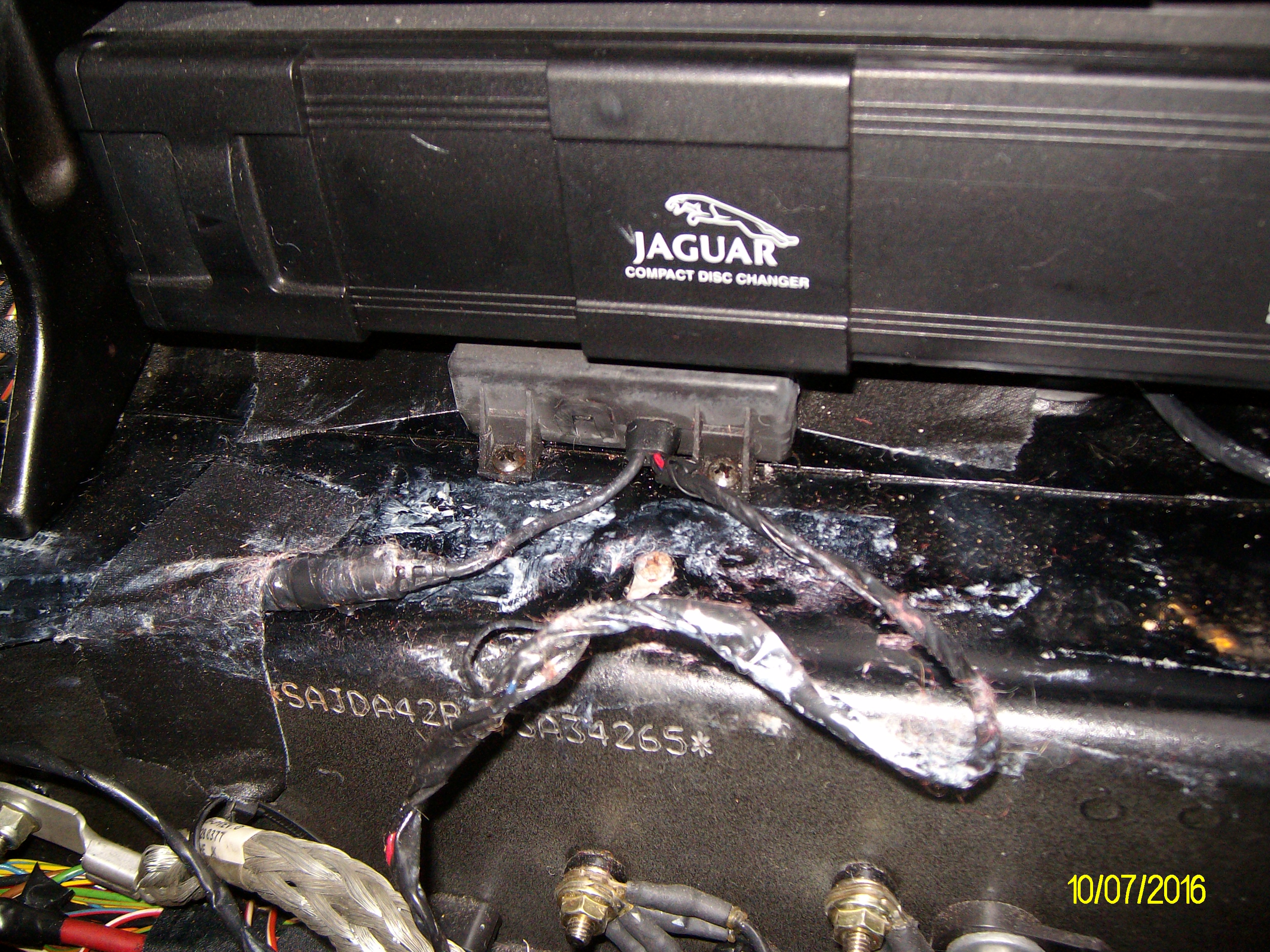

I have had trouble with a parasitic drain, although I had solved it for a while, or so I thought. For at least several months it did not plague me, but it has been back for the last couple of months. I have been working in the vicinity of this unknown component, and had gone through, at one point, and made sure all the fuses and relays in all the boxes throughout the car were firmly seated, finding several that were not, about the time my drain returned.
After pulling off rolls of black Gorilla Tape, leaving a disgusting sticky residue behind on everything, I have found a component that had been concealed by all the tape. This mystery 'box' sits underneath the pump and amp rack, from left to right pic-1&2.
It has been spliced into the large gauge red cable coming from the trunk electrical carrier, pic-3, with electrical tape.
It connects to some kind of antenna with writing that states: 'Antenna America Inc.,' and some patent and other numbers, pic-4, that was taped up underneath the rear quarter panel above the hydraulic pump.
Is this a remnant of some type of aftermarket equipment previously installed on my car, and only partially removed when sold, that I may have somehow re-activated when I re-seated my fuses and Relays? Could this small box, pic-5&6, be causing my parasitic drain, and if it is, do I just cut it loose?
Oh, and the hanging wire harness, obviously too difficult to re-attach to the brackets right next to it, is just another example of the crap work that was done by the dealership. In this example, an antenna motor had been replaced, and the passenger brake light assembly was replaced, and the wiring mess is the result; but this is the stuff that keeps me busy.
Thanks in Advance,

GPS tracker maybe?
And yes it might be the problem.

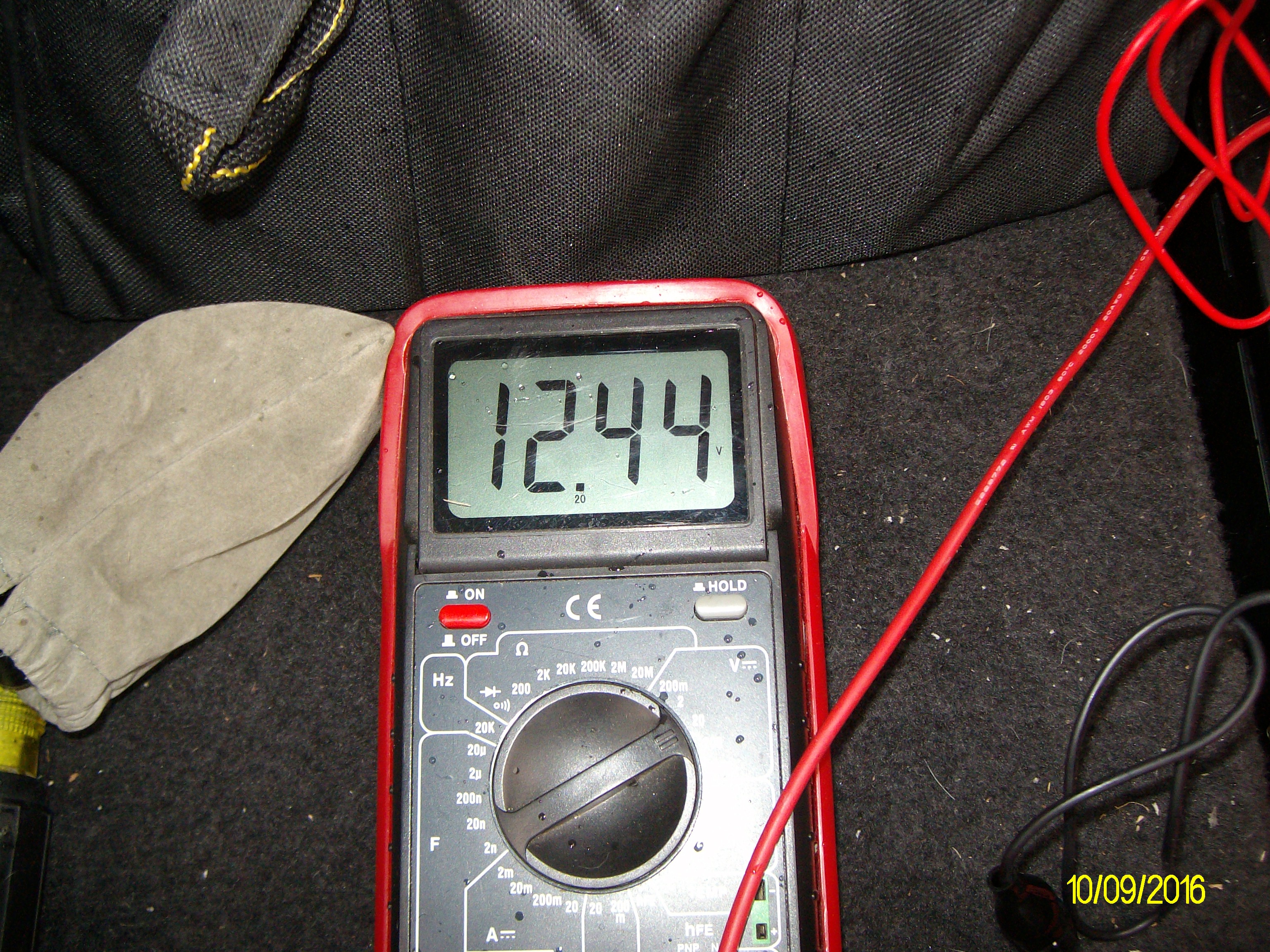

This is what I have found out about the 'box' under the Amp Rack. I took the following pictures, and recorded the information off of the box which led me to this description: 'IMETRIK LOCATE S VEHICLE GPS TRACKING DEVICE RECOVERY SYSTEM FCC IDILJU-03U', by LOJAK. Searching around the web, I found that it was OEM on the Jaguar X-Type one year and on a VW, and others. It's most common application, if not installed by the owner to utilize it's capabilities, is to harrass the sh*t out of a person buying a car from less than reputable Dealers, who will use it against you if you miss a payment. Apparently, it has the ability to not only broadcast the location of the car constantly, but can also immobilize the vehicle with a keystroke, and provides friendly vocal reminders that their payment is due or overdue.
I thought it had been spliced into the red 12V lead coming from the trunk's fuse box, however, after I removed the screws this afternoon, in between rainstorms, I found that under the tape, the cable's insulation had a square chunk cut out, and the wire was taped to the inner wire through this cutout. I had my meter hooked up to the battery to see what, if anything would happen, as the wire fell off the cable when I pulled the box out. There were three wires, but only the red and black were used, the blue was tied back amongst the mess of electrical tape.
My battery had already been drawn down by the time I went out to do this, so I do not have a baseline as of removal, but the battery had been dropping 1/2 of a volt over several hours.
Thanks
