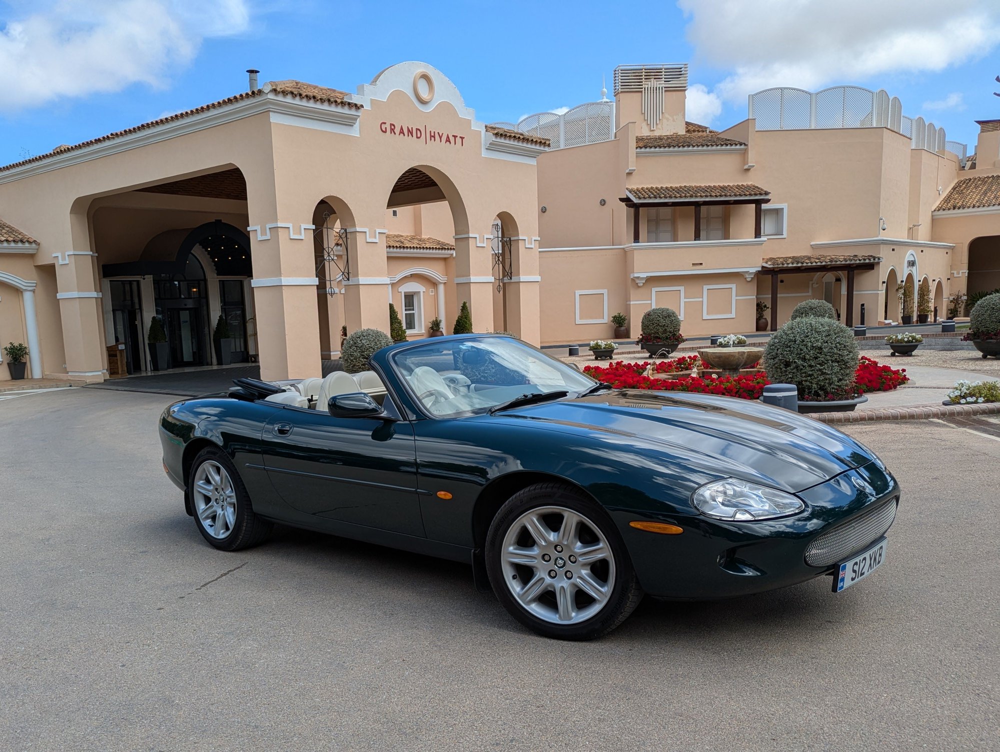

14 months later - an update.
In the end, a friend asked us to take their Mercedes E-Class estate down to Spain for them - it was going to save us a load of money so we said yes. We actually regretted this - the awful sports seats in the Merc gave my wife Sciatica and we took too much luggage, forgetting that we had to fly home!
This year we took the XK8. Armed with everyone's advice, we checked on our breakdown cover but also took a small bag with a few spanners, wire, wire-cutters, screwdrivers and gaffer tape. Even with a few cleaning cloths, workgloves and some other cleaning products and the mandatory set of spare bulbs, it took up very little space in the large boot.
Through France and much of Spain we clocked up just short of 5,000km in four weeks - a great mixture of autoroute, excellent A and N roads and crowded cities and towns. We used no fluids other than 98RON fuel at heavy European prices. It took a 509 litres in total - to save you working it out, that's a little under 28 miles per UK gallon - not bad at all and it was doing well over 30mpg on the autoroutes.
The car was a dream. Most of the time we had the roof down and were frequently waived at and chatted to by young boys and their grandfathers! Interestingly, we saw very few cars of this age or older on the trip other than the inevitable Renault 5's and Fiat Pandas! The emission controls all over Europe appear to be having an impact.
And did I use my toolkit? Yes - the bud dissolver and cleaning cloths saw lots of action. The car itself was totally reliable. It does now need a brake overhaul and one of the front foglight lenses got smashed by a stray stone but I can take my time with those and continue to use the car every day in the current lovely UK weather.
La Manga in Spain - as far as we got.
