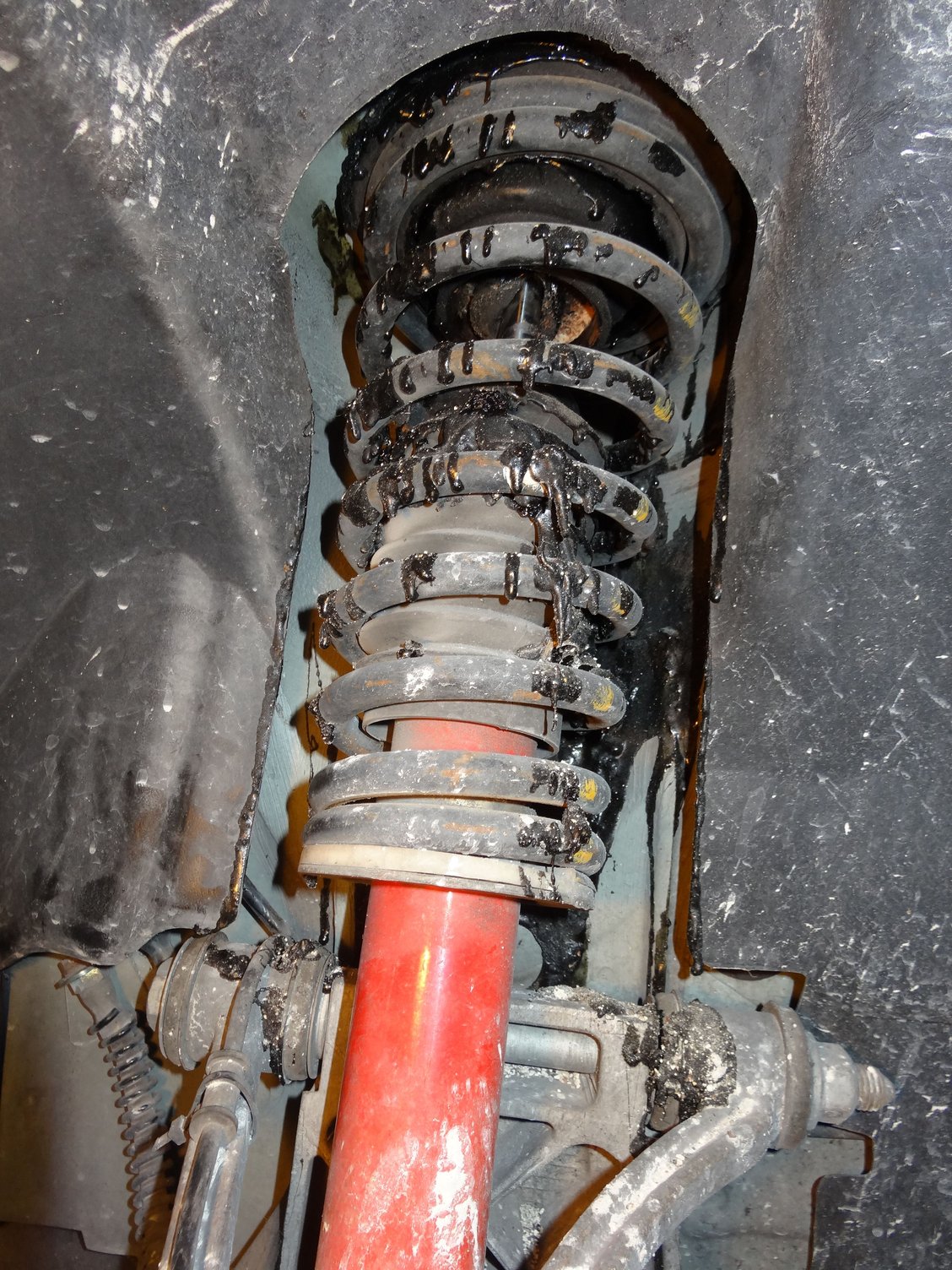

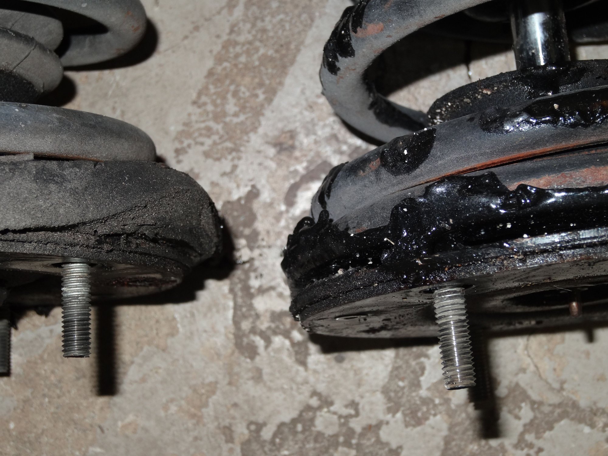

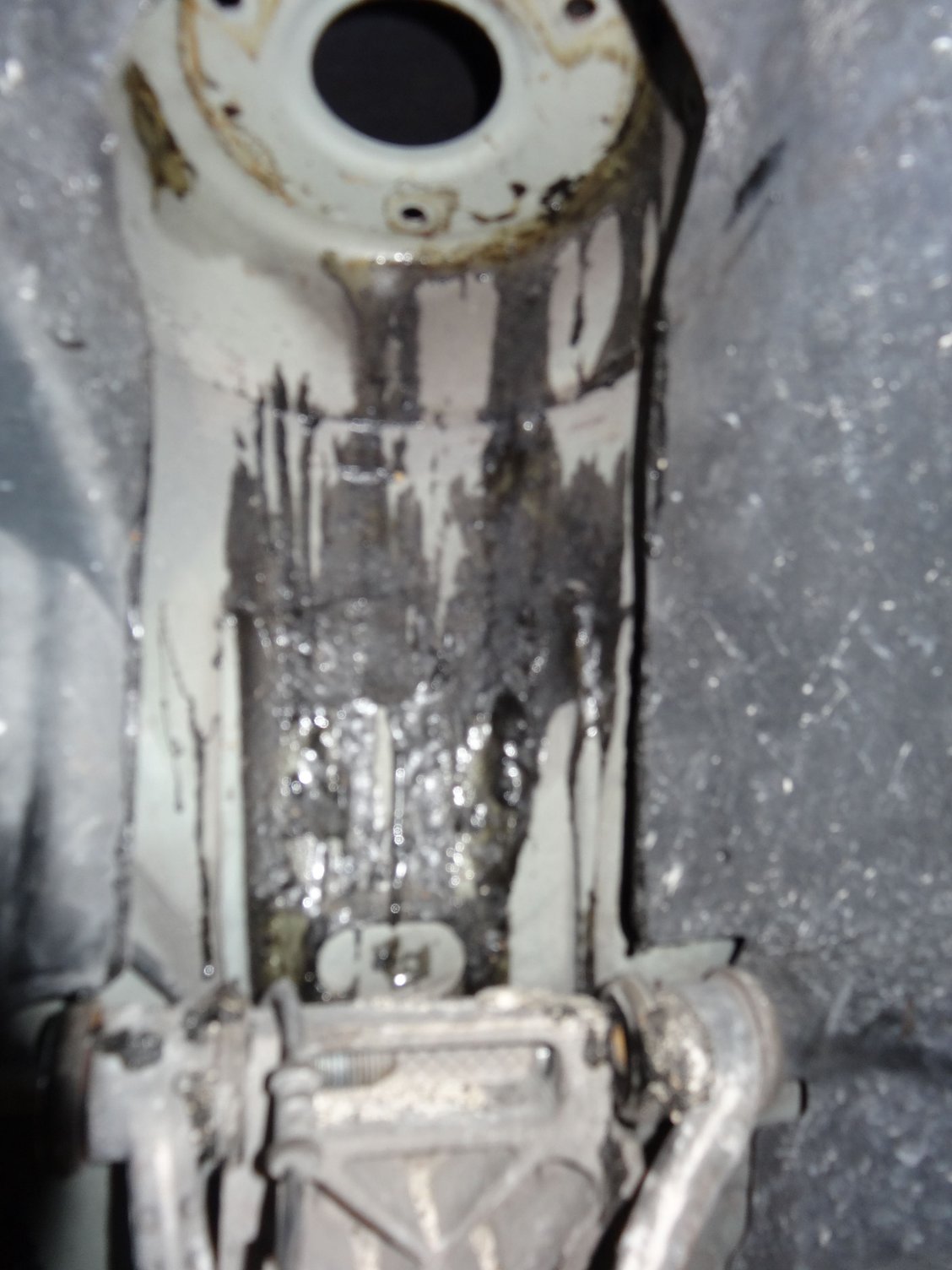

Default Update: Rebuilt Upper shock mount melt down
The upper shock mount rebuilt kit did not last even 10,000 miles. Wondering if anyone else had the same issues
with them? I will NOT be buying them again!
