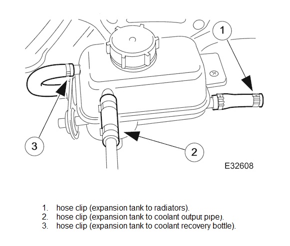

You have the XKR coolant tank/reservoir running in to a short rubber hose that runs into the right of a T connector that runs into 2 plastic hoses. What is that part? Or if it's not sold separately what hose do I need?

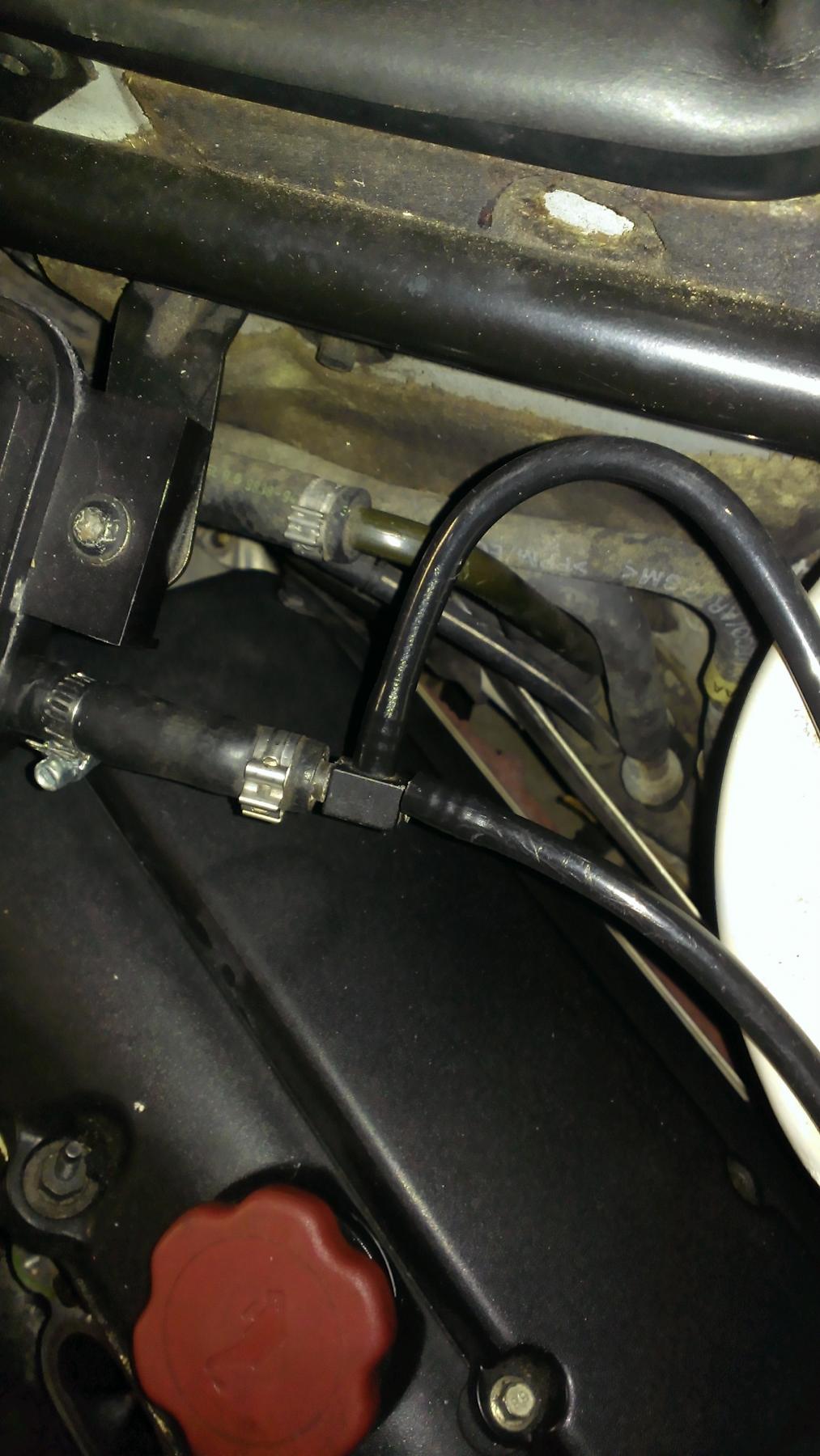

I'll ask the same question - what is the T Connector?
Given the short connector hose from the Expansion Tank to the T Connector has one original Norma Clip and one aftermarket Worm Drive Clip, someone has been there before.
I can't find it in the Parts Catalogue.

aode06: Yes it's damaged, I was going to remove and replace it but the thing was brittle so the 2 parts going in to the plastic hoses broke right off inside. Now I'm having trouble removing them!
Graham: Yes must of been my independent mechanic there before. I looked couldn't find it in the parts catalog as well.
