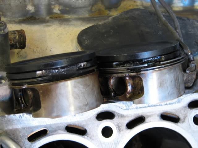

Glad you found your answers..... If you get pulleys done, drive steady for about 500 miles, your ECU needs to recalibrate itself to the extra air coming in otherwise you will run lean and damage pistons, a bit like these...
This is what can happen if you do a load of mods and just go out and give it the biggun

Ugly to say the least. So, you don't reflash the computer on these cars with an SCT or Diablo but instead let the car reprogram its self? My first thought is the 15 to 45 added HP may not be worth the hassle, I had no idea the supercharger was so maxed out.

Correct, these ECUs can self-adjust over a wide range, as has been well proven by our esteemed member Avos and his 100-200 HP Twin Screw KB supercharger upgrade.
The swap still provide some pretty good bang for the buck for light use where a cooldown period for the supercharger is possible. Improving the supercharger cooling can help further.
