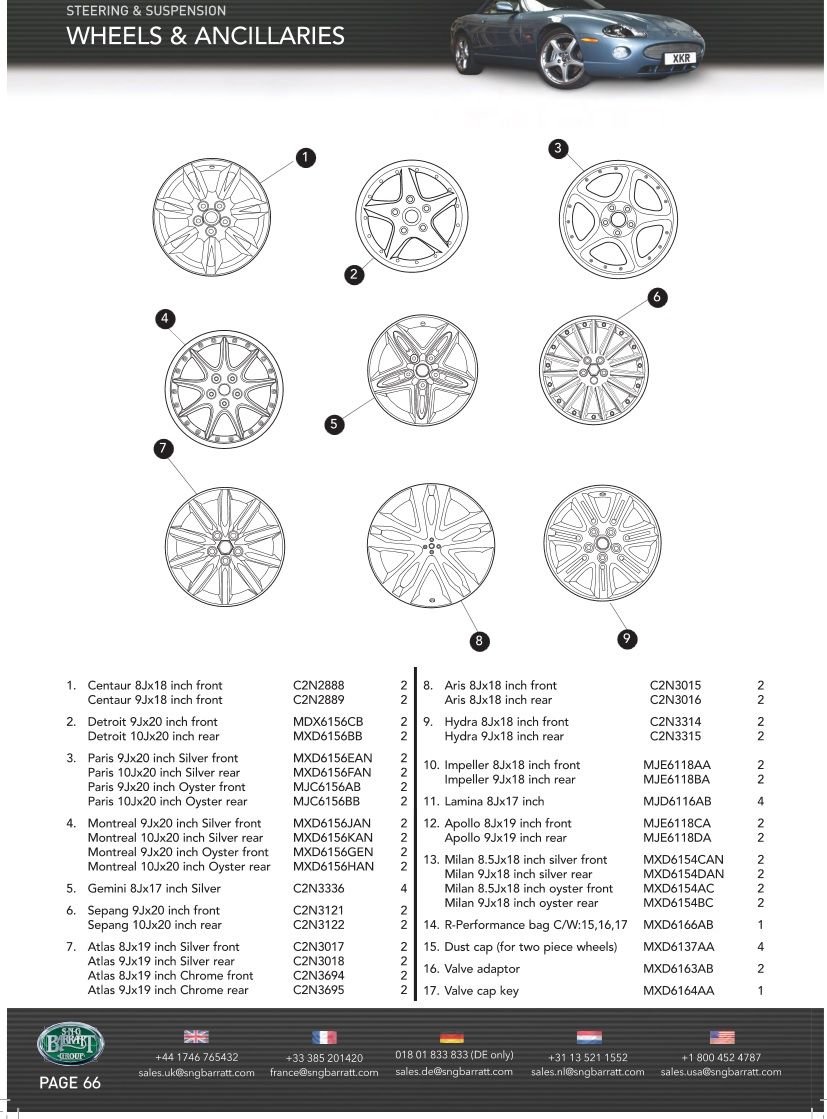

Any Factory X100 or X308 wheel will fit on a '97 XK8. You can run into problems with the bigger brakes on later models fitting earlier wheels
Here are the XK8/R Factory Wheels from the SGBarrat catalog:
The "Five Spoke" wheels (22) are known as "Revolvers", but this isn't politically correct.
