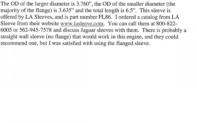

I also knew one on the jaglovers forum from a couple of years back that documented all the steps from his XJ8 (and had a head gasket failure), can't remember seeing a video, he made a very extensive document with pictures he sold for a few bucks (which I bought back then). Do you have a link to the one with the video, as it may well be the same person, would be interesting to know.
The last I remembered was that he made a silly mistake with the head gaskets, in that he test fitted with the gaskets, and reused them later again, which he thought could have been the cause of the head gasket failure he experienced not long after the rebuild.
Attached was what he had to say about the sleeves:
Did some more digging, and we speak about the same person (not sure where I got the test fit from though). Here is the post where he explained what went wrong with the liners with some good info (not so good machine shop afterall...): JagFORUM Logon
Here is the text for those who don't have an account there:
