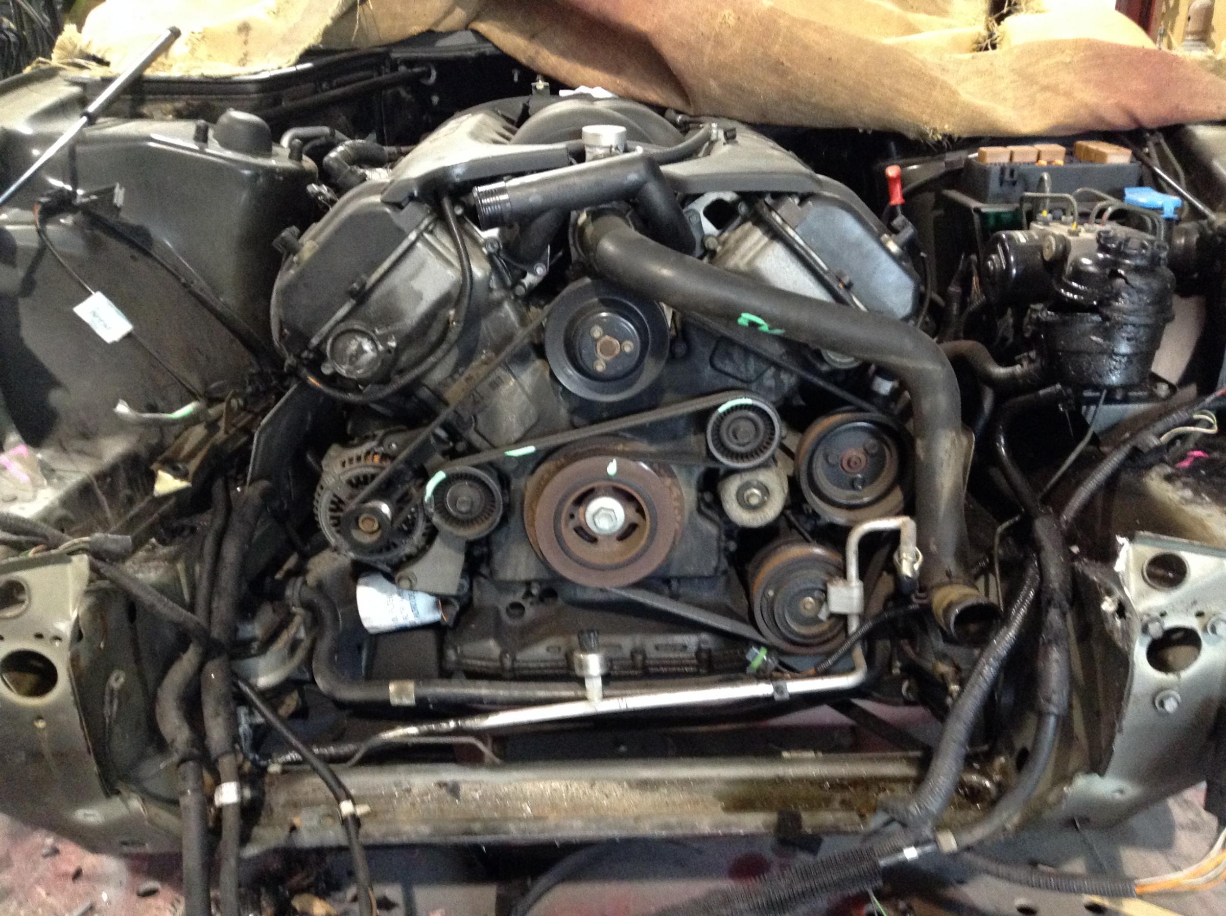

Front end is off my XK8 and before, I would have to put maybe a TEA CUP of coolant in about once a month. I found that somewhat manageable but still was curious where it was getting out. I could smell a light 'burned coolant' smell after short rides and couldn't find the leak.
With the front end off for a restoration of the front, the body shop was drawing DOWN the coolant system to put new in and it wouldn't hold. They found the slight leak IN FRONT OF THE aluminum THERMOSTAT HOUSING that I upgraded to a couple off years ago. I retorqued the bolts and hopefully that solves my leak.
I would have sworn that the leak WAS NOT AT THAT LOCATION but.....was wrong!!!
Check yours again and the 'octapus' hoses up at the firewall is also a likely source.
