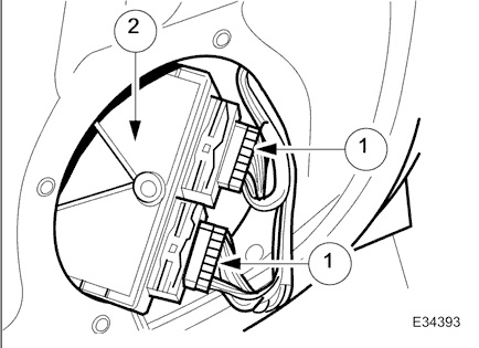

Does that module ever fail, or not so much?
Old Apr 11, 2018 | 06:00 PM
Likes: 17,004
There have been some reports on the forum of failures but it couldn't be described as a regular issue.
Bad news is the Door Modules come out through the speaker apertures so there's quite some dismantling required.
The two harness connectors shown in the diagram will give you an idea of the number of leads going into the door.

Graham, that is super helpful! That doesn't look too scary. I'm sure I'll be swearing up a storm, scraping up my forearms when the time comes, but that's just par for the course!
