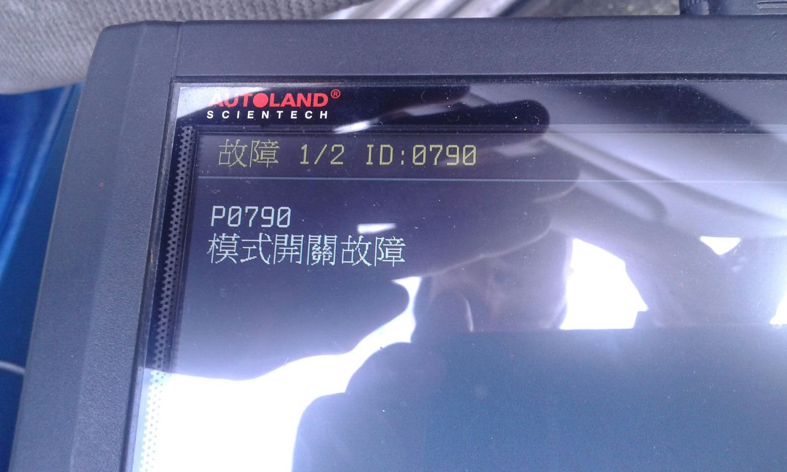

Hi Gus, got some error codes over the weekend(P0706, P0790), I was told they are historical, but I assume at least one of them is current? sorry I am not too technical about this, the second Picture with P0790 roughly translates to Switch Circuit malfunction. I done a bit of reading and see that the J gate lights seem to play a big part of this, I am getting someone to have a look for me if that bit of info is needed. thanks for all the help!

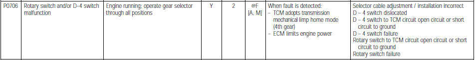

Hi.
Drive to 4 switch dislocated/connection/malfunction.
Rotary switch adjustment.
Attached Thumbnails X100 Rotary Switch problem-rotary-706.png   X100 Rotary Switch problem-rotary-790.png
