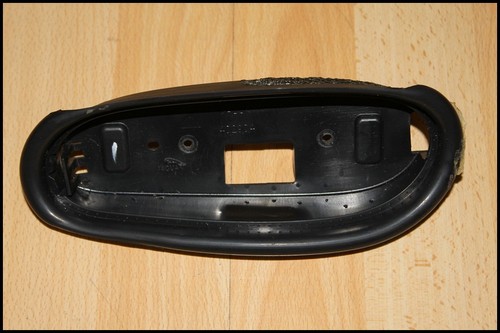

More often than not, it is the black 'cup' that the switch module snaps into that breaks, not the switch module itself.
Note the tab on the left of the photo...that is what usually breaks off.
You can sometimes find used ones on ebay, such as here: Jaguar XK8 XKR 1996 2006 Seat Switch Housing Front Right Free P P Mounting | eBay
It is also possible to repair it by drilling a hole above and below the tab, in the same plane as where the latch on the switch module engages the tab. Run a piece of coat hanger wire through the holes and bend the ends to keep the wire in place. Problem solved! Priceless!
