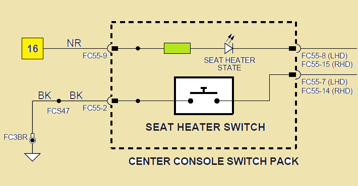

Do you have a pic of the component side and circuit side of the area of concern and can reverse engineer it as the wiring guide only shows a classic circuit of a LED in the path of a ( classic current protection ) resistor . The dot is the tie in point for the other LED's
