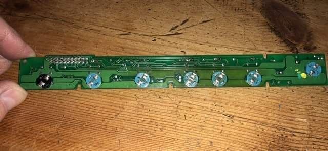

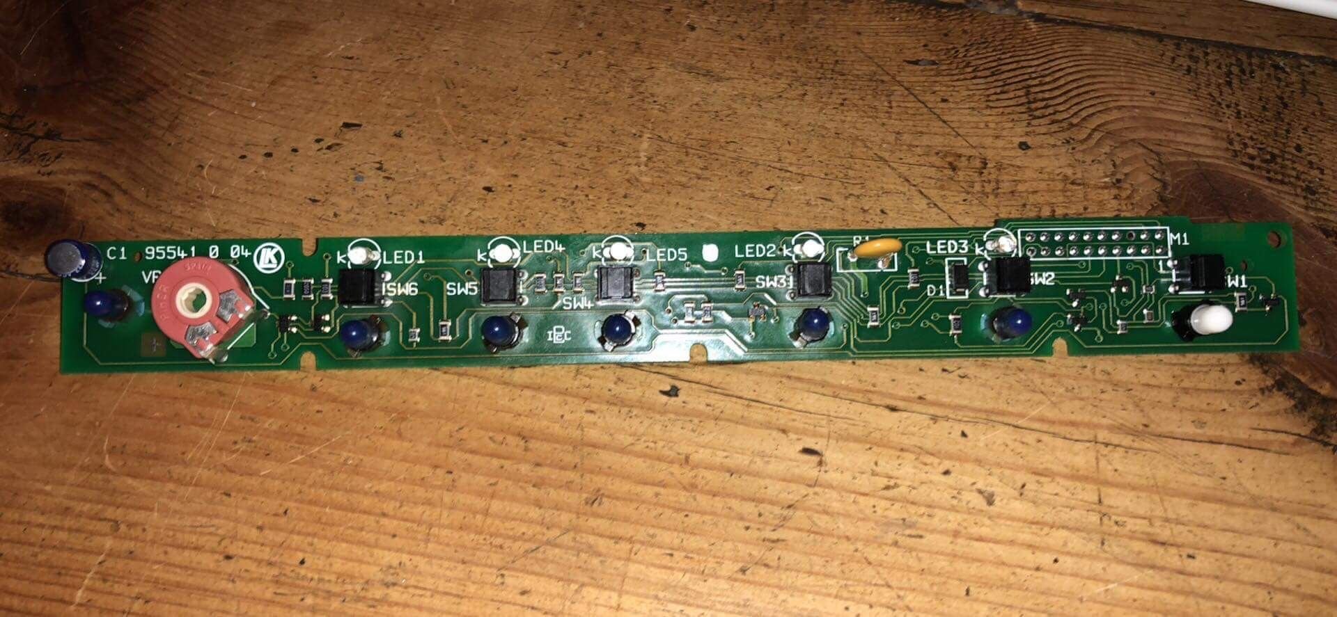

I'll get a photo of both sides up shortly.
Thank you both for your help!

I soldered the varistor back on to the board, and decided that it must be a break on the board somewhere that was causing the issue. So my first simple idea was to plug the board back in, switch the engine on, activate all switches then give the board some very light twisting to see if a broken connection might temporarily pick back up...
