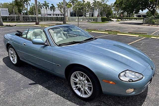

I recently purchased a 2002 XK8 convertible with 70K miles on it and I absolutely love this car. Cosmetically, it's pristine. But, there's an issue with the convertible top and its operation. First, it doe not latch when the roof closes. I get an error message on the dash "convertible not latched". Secondly, the roof does go up and down, but it moves very slowly and sounds as though the power or motor is straining. Thirdly, the rear windows on both sides don't go down when the roof is being opened. I'm not operating the roof at all until I get these problems fixed. But, I'm wondering if having the "not latched" error message on constantly is affecting any other aspect of the car's operation and performance, such as: is the car's speed and ease of motion restricted due a safety concern? Any insight or advice would be greatly appreciated. Thanks!
