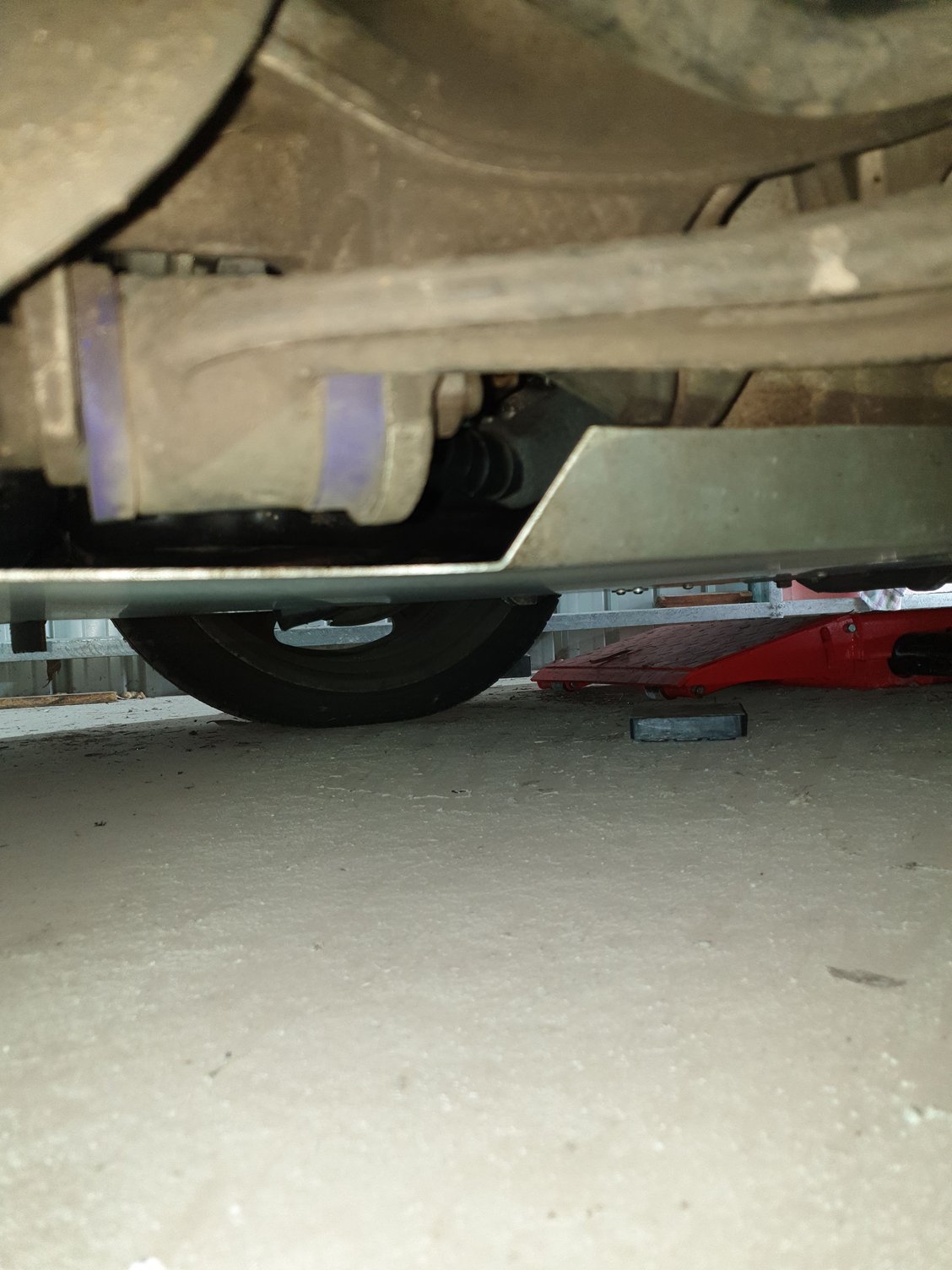

Originally Posted by giandanielxk8
The rear requires dropping the rack and pinion. The front, if I recall correctly, doesn’t require anything. The nut faces the front of the car, and the bolt comes out towards the rear. Barring improper install if the subframe has been dropped before, check to see if the oil cooler lines are not impeding access. They can safely and gently be repositioned. Their bracket is flexible.
Front most pivot bolt nut to rear Gian.
Bolt inserts from front of car, but it's easy enough to move the bracket that restricts the removal of bolt.
Not a good pic but nut can be seen toward rear.
