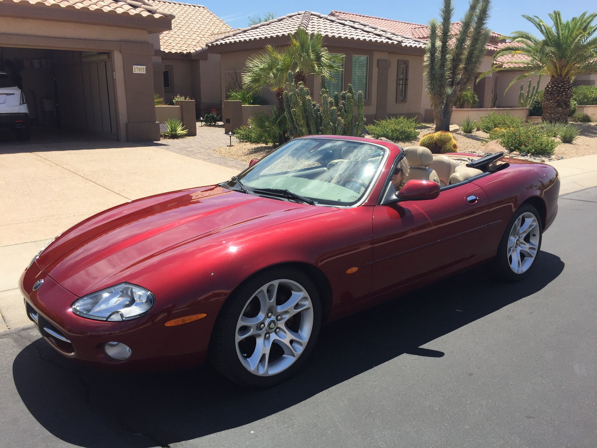

Thanks to all who offered advise. I wanted the 4.2 motor
Randy
