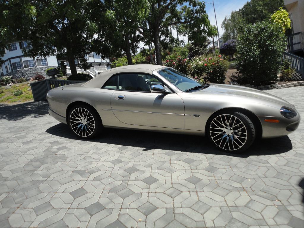

Default Oh and here are some shots of my babies
Here are some shots of my Jag family (I don't have the 8 anymore). By the way the wheels on the 8 and the R are the same wheels, I just had them powder coated black because every time I hit a curb it was $450.
Attached Thumbnails XK8 vs XKR-wp_20140715_14_06_03_pro.jpg   XK8 vs XKR-wp_20140419_12_03_40_pro.jpg   XK8 vs XKR-dsc00635.jpg

Default Nice stable
Sweeeeeeet!
