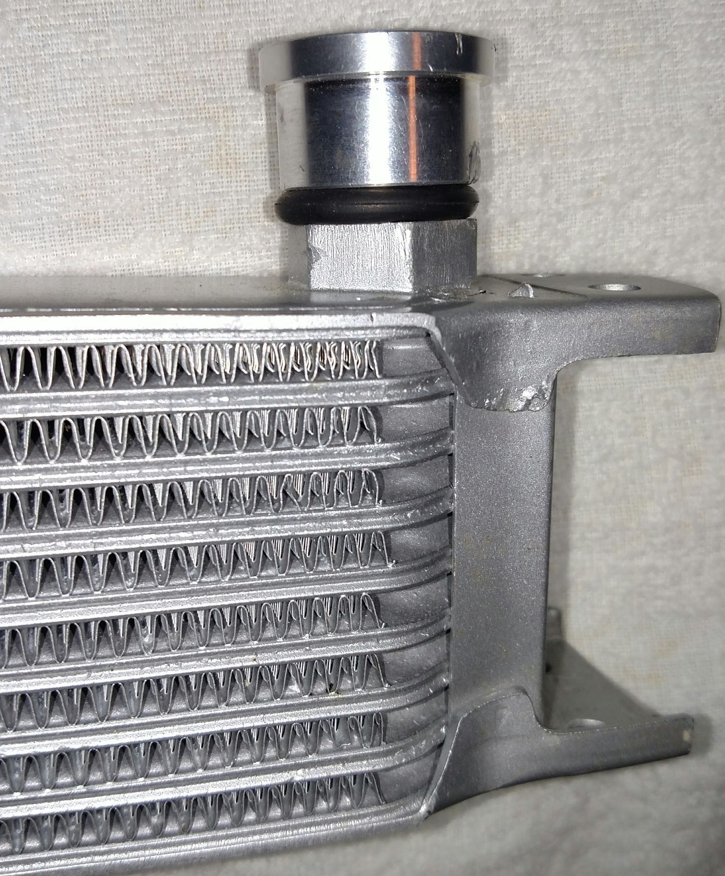

An easy and less expensive way to replace is to find a tech school near you that can fabricate a part from a solid T-6061 or 4047 Aluminum bar billet. Buy any oil cooler with an overall width/height and core (row) size as old cooler.

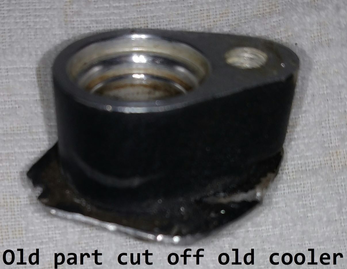

What I did was cut the female connection off the old cooler (pic #1) and took it to my local tech school.
They had a fancy lathe that could fabricate that part from a solid piece of aluminim (pic #2a, 2b & 2c) - have them make 2.
If they can, also have them thread both the hole on the tapered part to match the threads from the cut part (for the connecting bolt) but also the end of the new part that's to attach to the new oil cooler with #8AN threads either female or male to fit to new oil cooler. I didn't think to do the latter part so I had to order 2 weldable female bungs (pic #3a & 3b) and have the tech school weld them onto the new part.
Weldable bung
Weldable bung
Bung screwed onto new cooler with
Bung screwed onto new cooler with "O" ring
Simply screw on the new part to each side of new cooler and connect to "teardrop" pipe (pic #4) on the jag.
Then attach new cooler to jag mounts with new bolts with the rubber grommets.
