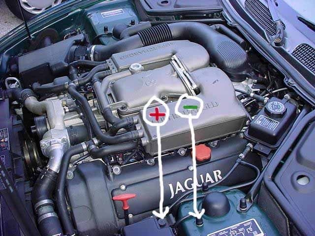

We have had this discussion in other model threads about CTEK battery tenders which offer alternatives of plug or terminal connections.
The XK and F-Type accessory (formerly known as lighter) sockets are NOT permanently 'live' and cannot be used for charging. I used CTEK's when I had my XK8's and used to connect them to the battery so must have discovered the socket was similarly not 'live' with ignition off.
An alternative to 123go's suggestion of running an adaptor/extension to the battery is to run it to the terminals in the engine compartment:
Thanks to member Paul Pavlik for this frequently used photo of the connections used to charge a flat battery.
