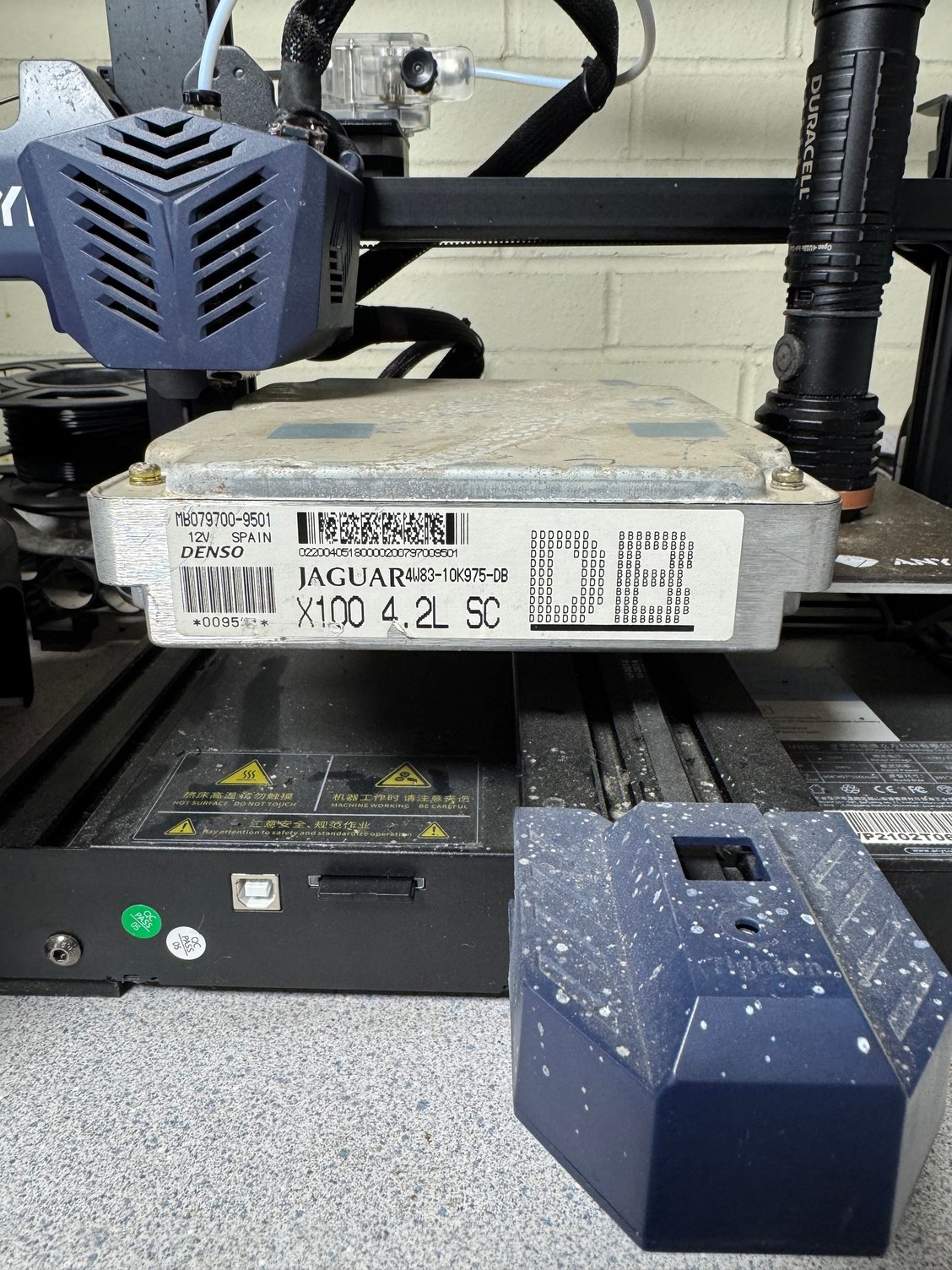

Default Need ECU for a 2005 XKR
Hi, first time on the site so if I break the etiquette please let me know. I just bought The 2005 XKR. It was flooded and is in need of a replacement ECM. The serial# I need is
MB079700-9501. I have looked almost everywhere with no luck. Can anyone point me in the right direction?

Hi,
That part # is not the Jaguar designated one. What are the last 6 characters of your VIN?

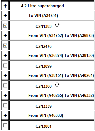

From: Indiana
A42492 last 6 of Vin

OK.
The Electrical guide shows:
...so the Jaguar part # for your car is C2N3339. Unfortunately, as you've seen, it isn't printed on the case of the module.
It does give you a VIN range to work with for a replacement, and should help as a cross-reference in your search. (The 4W83.... may help also)
Note that it's not a straightforward module swop on the 4.2L - you will need access to a Jaguar diagnostic tool to configure any replacement.
I've attached some documentation that describes the process.
Good luck!
