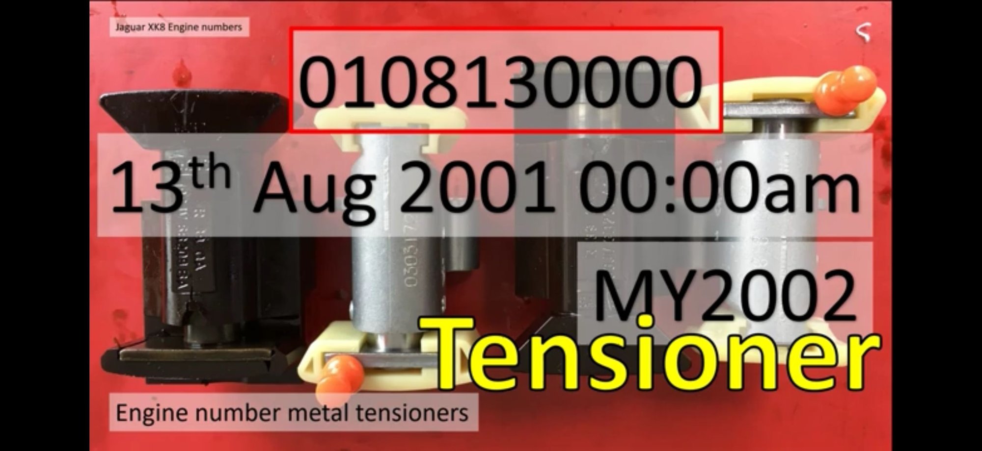

Don't forget the 2002. Most had metal.

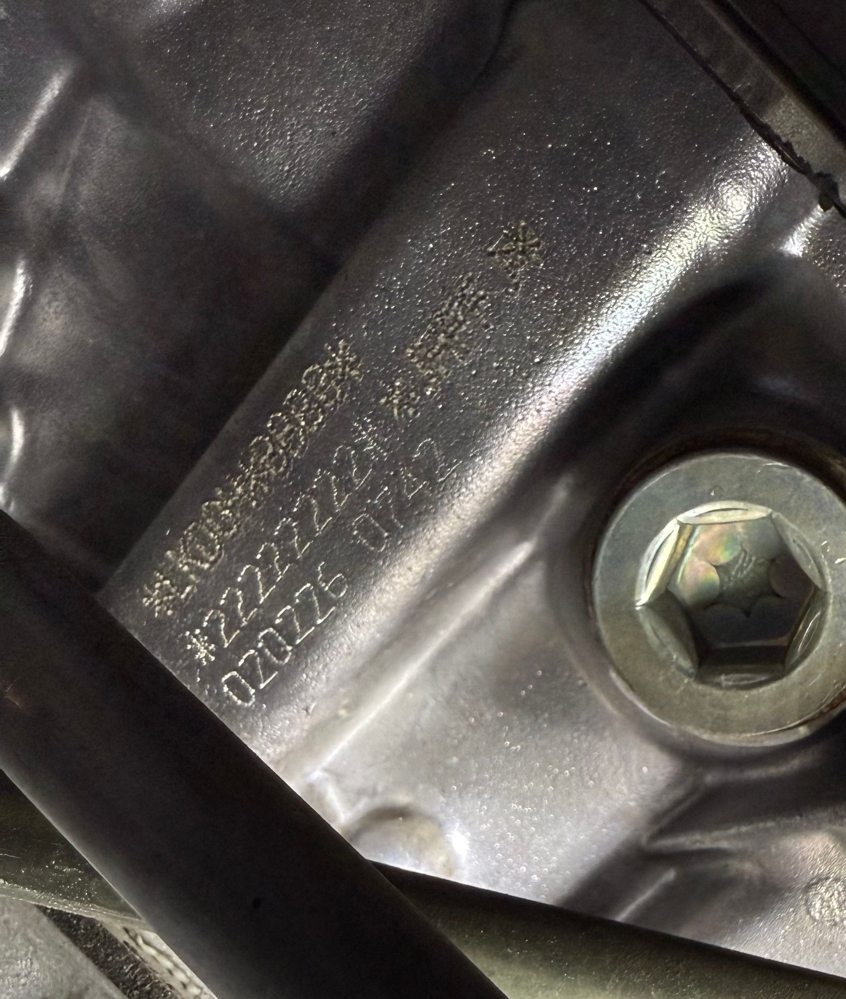

Remember that the metal TC tensioners came on all AJ engines built after Aug 13, 2001. To see this date you have to look at the left side of the engine block, which is easily done (haha) with a smart phone and a flashlight. Don't jack the car up, just stick the flashlight (damnitall, i mean torch) into the engine compartment near the torque converter (shining forward) and put your phone next to the block. You might find that the 2002 in question was produced after that glorious date. The picture of the block is my 2002 engine (02/02/2026) that went into my car, build date of April 2002 on the door. You can see that it took two months from the engine build to rolling off the assembly line.

2002 Feb 26 @ 7:42 in the morning engine build date shown above.

Isn't that what I said? Or not. Dyslexia only strikes once. Or is it twice? Maybe my engine is less than two months old. I'll have to check.
@motorcarman added the time of day
