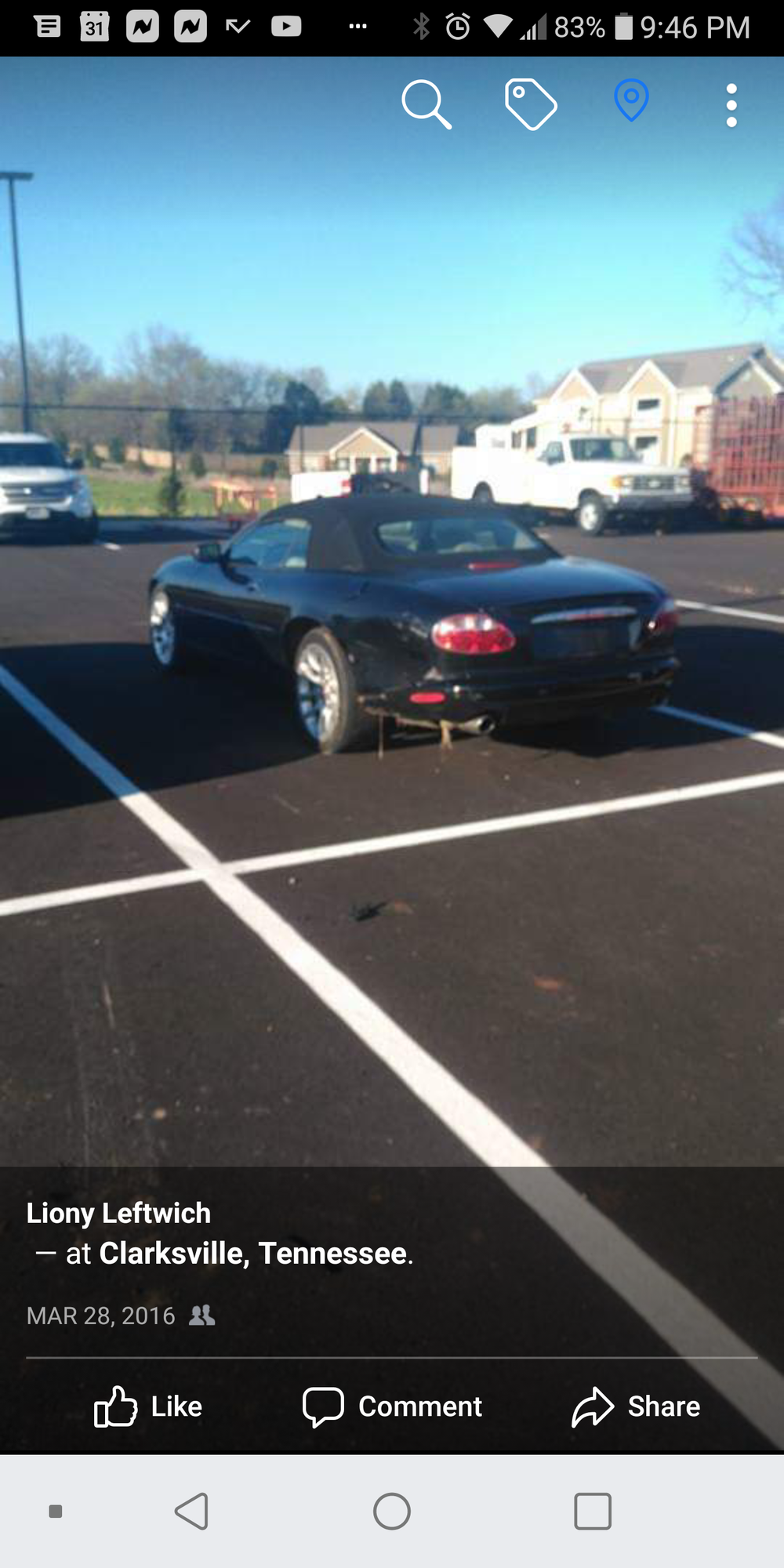

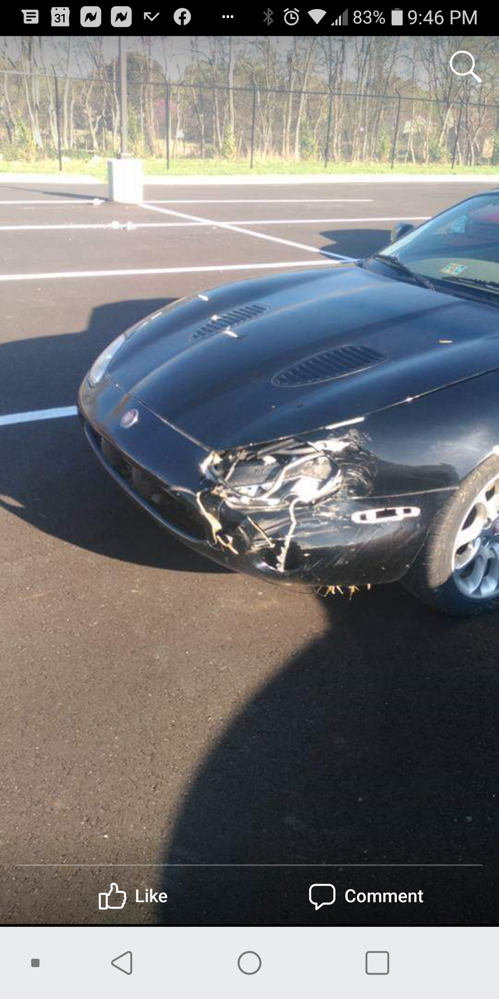

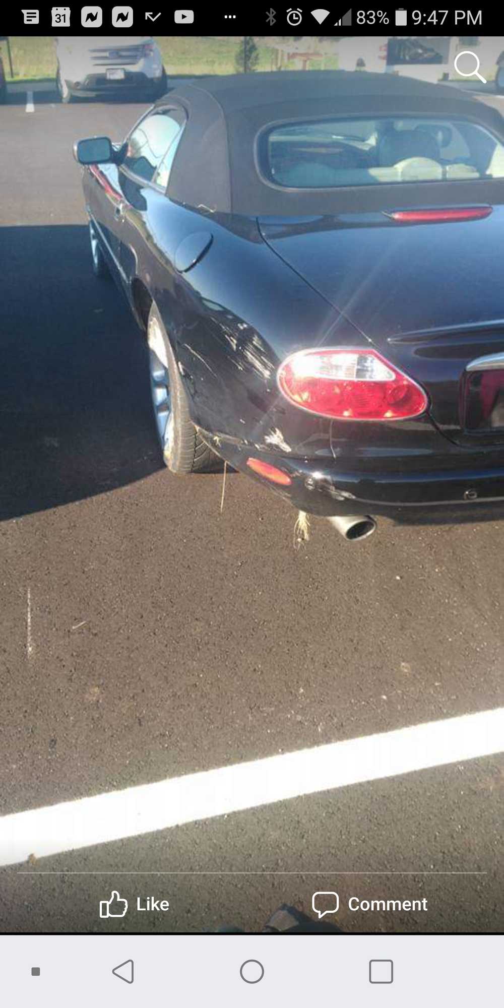

You might have bought my 2001 Jaguar XKR that I had an accident in.Is it a black convertible with beige interior with over 100,000 miles?But when it rained and it hydroplaned,I crashed into another car and damaged the front bumber,tender,and quarter panel where the gas tank is.I think the body parts just needed replacing but it probably messed up the transmission too

this was it before and after the accident😞
Before
Before
After
After
After
