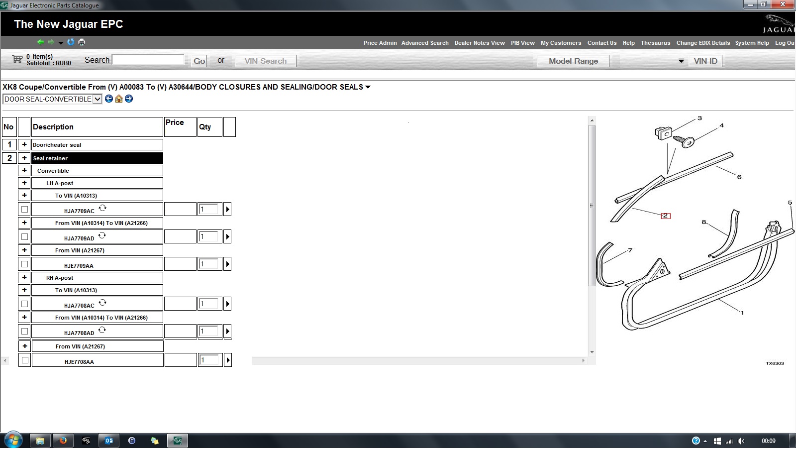

Old Feb 15, 2016 | 06:14 PM
It looks like the rather unimaginatively named Seal Retainer (item 2):

OH I thought you were referring to the door window strips just aft of the mirrors on the beltline. Sorry, the ones on the windshield pillar are attached with screws along the length inside, top to bottom. I have those pieces too if your interested.
Sorry for the confusion.
