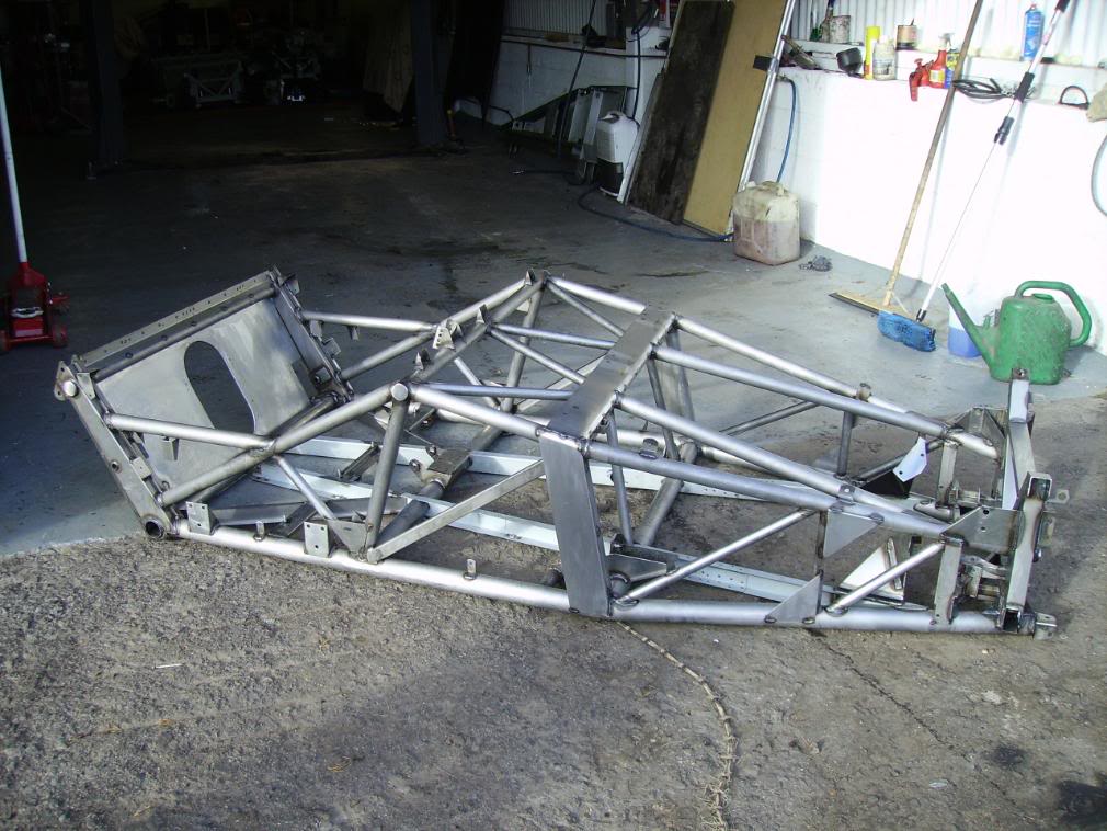

Well, you asked for it so here it comes. Firstly, like any new Jaguar model, it was a prototype. Think of the alloy bodied XK120s and the very early E-types as an example. Jaguar are finding their way, designing a car on the hoof, making things work and - most importantly - changing as they go. Here is a photo of the chassis of the replica of the Le Mans 1952 C-type I built, and this chassis was copied from an original C-type:-
Now my car was a copy of XKC 002, but here we are talking of of XKC 003. One number apart, but - and a very big but - were the chassis so different or did I make a blunder? Here you see a photo of the cockpit chassis of XKC 003, and it isn't tubular, but airframe construction for lightness.
Should my car have been the same? I had substantial advice from two surviving drivers, so I feel not, but time passes. Is Jerry right in his reconstruction of 003? Personally I'll give him the benefit of the doubt and think I was wrong. He made such an effort and found material I never had access to.

Great photos of your build thanks Lowdrag. Do you have more?
Ever since I first saw a c-type I've wanted to build one. Like you I'll never afford a real one and I can't even afford a commercial replica.
I started taking courses on restoration and panelbeating, but getting plans is proving elusive. You would think that with the C-Type out of copyright that copies of plans would be available on every street corner, but the commercial replica guys who have them keep them very close to their chests. I've approached several, but they won't cooperate.
Can you point me to any good information, plans, detailed measurements & drawings?
