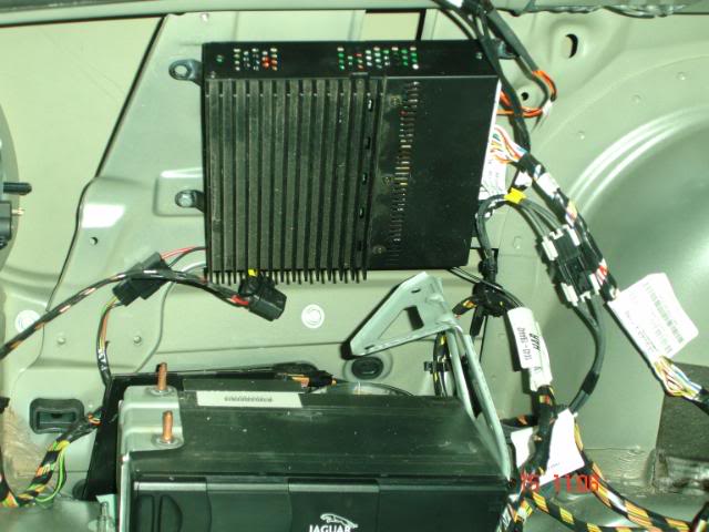

If your car is -2004 then the amp will be under the rear parcel shelf buillt into the sub box.
If you car is 2004- then the amp will be in the boot behind the LH trimnext tothe side wall.
The HU and amp are connected to the speedo and if your car has a cd changer,voice control and satnav.All of theseunits are connected together using a D2b lead (fibre optic).All must be daisy chained correctly for the system and any of the components on the fibre optic system to function correctly.

Hi Buck - Thank you for the info - my car is 2005 so the AMP should be over the CD Changer - unfortunately there is not one there and no subs either
obvioulsly removed. I did see your install (looks good) but didn't know if that was the stock location for the AMP.
