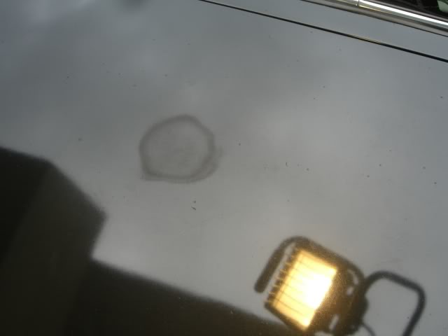

Showing poor paint condition and a bad oxidation spot on the trunk:

Starting with the Clay Bar on the trunk:
Working in some cut and polish steps to remove the oxidation and imperfections and restore the paint condition:
