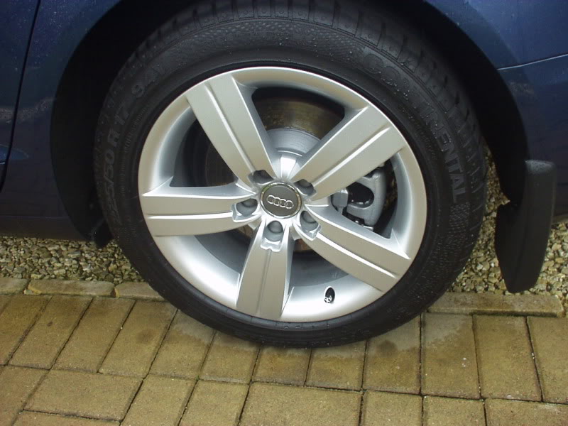

Ok, so here's a pic taken when tackling the inner wheels and the wheel well liners. Its not the best, but shows how the caliper n hub have faded and taken of dirt n grime over a long period of time. The lustre's gone and there's alos a few bits of paint flaking here n there....Not really pretty!

Here a couple of pics of the front wheel calipers and hubs freshly painted with the clean wheel in place looking a million times better

Here's a couple of the rears freshly done and looking good too

With them on the car its almost impossible to get a 100% perfect result, but I took my time and really tried to do the best I could. It is so worth the effort involved
