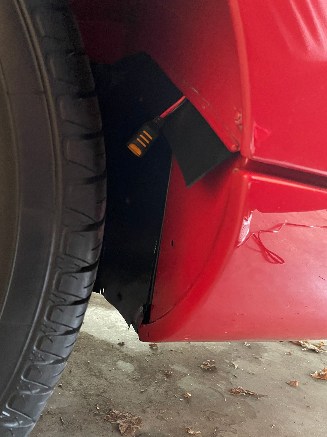

I suspect you were hoping to be able to use a battery maintainer hooked up to the cigarette lighter, so you wouldnt have to open and close the bonnet to mess with the charger.
I installed the battery connection part of my Ctek charger to my battery with eyelet terminal connectors (not clips), and then ran the end of the the wire with the “quick connect” connection to my wheel well. Now, I can quickly connect/disconnect the Ctek to the battery without having to mess with the bonnet:
It has worked great for years. Hope this idea helps.
great idea. Thanks for the tip.
Excellent idea. I’ll give it a try.

Default The CTek
I would be careful, though, about driving around with that connector hanging out.
I’ve done it for years. No issues 👍

From: On the Faultline
I'd certainly want to put a fuse (maybe 5 amp) close to the battery at the (+) terminal. Better safe than sorry!
Over here in the UK, my concern would be the amount of wet and crud that could be thrown up onto the connector. Probably wouldn't live long being exposed there. If you drive in nice dry conditions, probably not a problem. Lucky you!
The car never sees rain.
