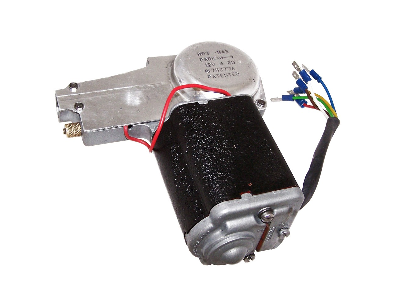

Originally Posted by phoenix1
Hi can anybody tell me if the wiper motor is fitted to any other car and not just Jaguar . Thanks. Bryan
The motor is a Lucas item and will have been fitted to many British cars. The differences centre on the rack, its tube, and probably the wheel boxes and the chrom-plated escutcheons on the top of the bulkhead. These vary according to the wiper location. E-types, for instance, started out with three wipers, then reverted to two, but the motor remained the same, but note that a permanent magnet motor was introduced by Lucas. This is easy to identify by its round from, compared to the square field-existed motor.

Yes mine has three wipers . I was wanting to know if I could source the motor elsewhere say British Leyland models etc . I know my 69 Mini has a similar one . Bryan
I would say you can, but I'm not an expert. For instance, some cars have only single speed wipers, some two speed, and I'm not sure how that is dealt with in the system. If you can find a motor where all the wires and colours are the same as the one you have already, then it will be OK.
