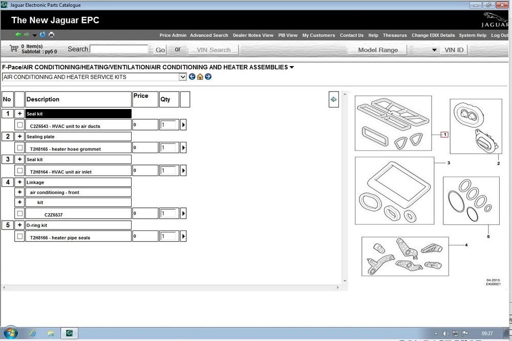

My F-Pace hadn't been used in a week and when I got into it on Sunday morning there was spider's webs all over the inside. It had been locked with all windows closed.
Not a problem I've had with any other Jaguar and my first thought was nothing should get past the AC filter to the interior of the vehicle. The filter had been replaced recently. It was still clean, fitted properly and the housing correctly assembled. This led me to check the AC and heater system layout in the Workshop Manual and the Parts Catalogue. I was very surprised to find Heater Service Kits specifically listed for F-Pace - they aren't listed like this for other Jaguar models:
There is clearly a recognised issue with sealing in this model or the replacements wouldn't be offered as kits. Unfortunately I don't have access to TSB's (Technical Service Bulletins) to see the advice given to dealers.

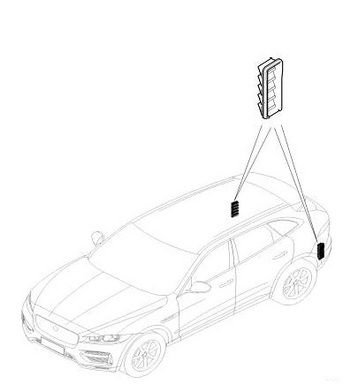

There's a Grille Duct on either side of the luggage area to prevent that.
Hinged flaps to allow air out but prevent water from entering.
