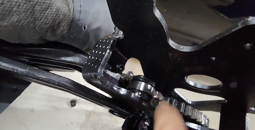

Ok here's a video of the top removed and a broken receiver nut obstructing the top from opening:
Removal of the hex bolt and receiver nut from both sides enables manual opening as well as closing (see comments). Here are some stills, hole is just left of the finger.
Two-person job to remove, 2 bolts from each side to the body?
