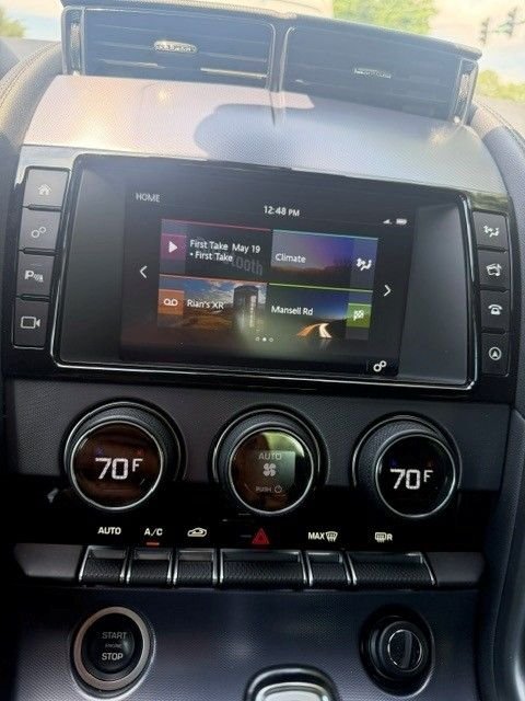

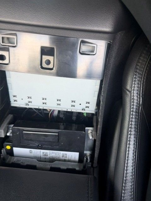

Good afternoon all. My name is Rian. I have a 2018 Jaguar F-type and it is my favorite car I have ever owned. In my opinion, its only drawback is the infotainment system, more specifically, the lack on apple carplay. Now, I did some research on the matter and most people on the forums have went with some sort of piggyback add-on unit that fits to either a Bosch or Harmon head unit. My car being an 18' with the updated screen graphics, I thought that it was a Harmon unit. So I ordered a Harmon Carplay receiver. Much to my surprise, when I pulled the rear console cover off of my F-type coupe to inspect, I found that head unit does not look like a Bosch nor Harmon. Upon further investigation there was a small "switchover "window that where some cars received a newer headunit but with the crappy, older/smaller screen. I understand that the 2019 cars got a larger screen with Apple Carplay capabilities.
So here's where things get dicey. From what I have researched, my car is eligible the OEM larger screen and it will work with the current electronics but it is not as "plug and play" as it sounds. Apparently, in order for the screen to be swapped, some trimming needs to happen to fit as well as a new bracket, bezel and upper aluminum trim piece that works with the larger 10.2 inch screen. Not to mention, once the screen is installed, then it has to be programmed by JLR to the newer graphics. I really would prefer NOT to go down the route of the newer screen as I do not want to cut, trim and program. Is there any other method that will work for the "NON BOSCH/ HARMON" (later INTOUCH pro) radio that I do not have to jump through those hoops. Hell, I wouldnt mind one of those android screen units if it would work with my current head unit. I would really appreciate the help yall. Im at my wits end here. Below is a picture of the radio and screen.

It is spelled HarmAn Such as Harman/Kardon. You have IMC system. You are really in the (un)lucky year. I don't think I have ever seen a aftermarket unit for this, on the other side, you can go OEM and that is the best way.
More on this https://www.jaguarforums.com/forum/f...2017-a-246306/
