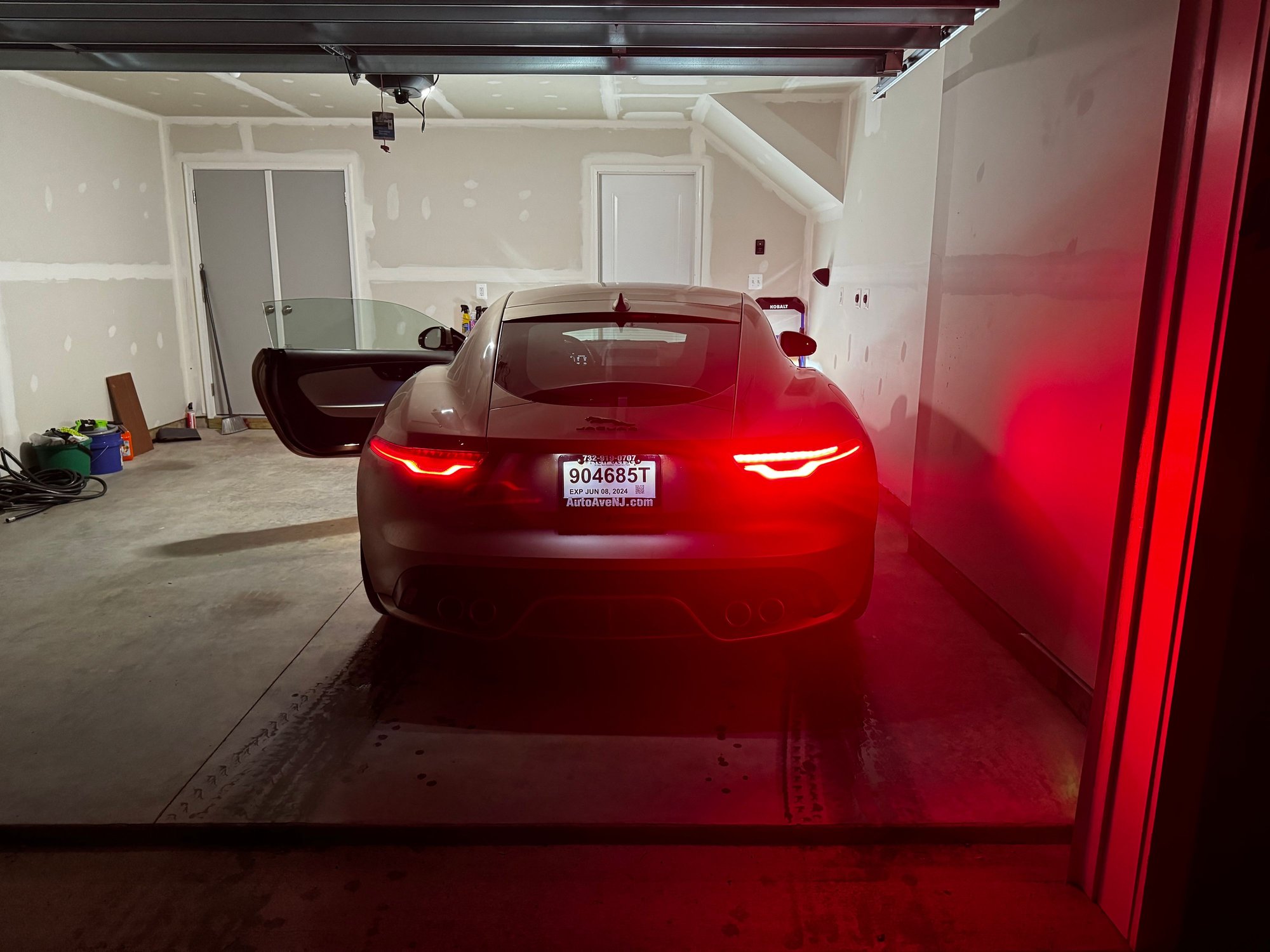

The rear parking lights have two sets of LED's
My left hand TOP row of LED's is dead.
I expected to just pop the cover off and find a loose connection, but this appears to be MAJOR SURGERY.
Still under basic warranty, but would like to avoid a 2 hour round trip to the dealership.
Anyone else been down this road?

that row of LED's lights up when pressing the remote door lock key fob
told dealer that
sent pix to dealer
dealer said its a bad lamp assembly and ordered one for me.
Hopefully thats the fix and under warranty
